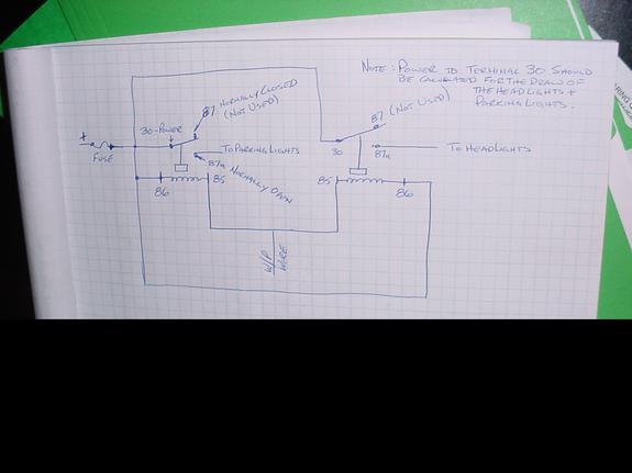

I am trying to post that diagram but it tells me that the file size is to big how can i make it smaller it's about 312,000 bytes in a GIF format the lowest i could get it?
Here it is thanks to hoppy but i don't quite understand it, are there 2 4 pin relay's in there? and what color wires are going in to the numbers. Also what position does the W/P wire come in at??? Could someone explain this to me in more detail cos i am **** with electronics.
RELAY #1 RELAY #2
30 (POWER) CONNECTED 30 (POWER)
__|___ __|___
| | | |HEAD
86| | 87A- PARKING LIGHTS | |LAMP
| | 86| |87A
______ ______
85 85
TO W/P WIRE TO W/P WIRE
RELAY #1 PIN 86 IS CONNECTED TO RELAY #2 PIN 86
RELAY #1 PIN 87A IS CONNECTED TO THE PARKING LIGHTS
RELAY #1 PIN 30 IS CONNECTED TO RELAY #2 PIN 30 AND WHICH THEY ARE BOTH SPLICED INTO A 12V CONSTANT POWER SOURCE WITH A FUSE...
RELAY #1 PIN 85 IS CONNECTED TO RELAY #2 PIN 85 WHICH ARE BOTH SPLICED INTO THE W/P WIRE
RELAY #2 PIN 87A IS CONNECTED TO THE HEADLAMPS
Hey Hoppy, what pin is the ground? Isnt it pin 86??? or is it just grounded when connected up to the headlights and parking lights? And, also...the wiring to the lights, did you do it at the light switch??? Or routed the wires to the headlights themselves?
geez, that got all messed up...o'well, the directions to the pins on both of the relays are there though...
Hey Guys,
it doesn't matter what terminal you use for the coil. You can use 85 or 86 to ground. But keep in mind that the W/P wire grounds these connections through the mirror. You have to supply power to the other coil, being 85 or 86 so the W/P can ground and put power through the coil of the relay and close the contact between terminals 30 and 87a.
The wiring, I hooked it into the wiring at the headlight switch, not the headlights themselves, or parking lights for that matter. One thing else, I have a problem with the lights on warning chime when the autolights are on and the door is opened. So, that said, I am not sure, but there may be a relay located on the passenger side on the frame rail area under the alternator that houses the parking light relay, and quite possibly the headlights as well. If there are relays for these circuits, this might be a way to eliminate the warning chime, but don't quote me, as I haven't investigated it yet.
