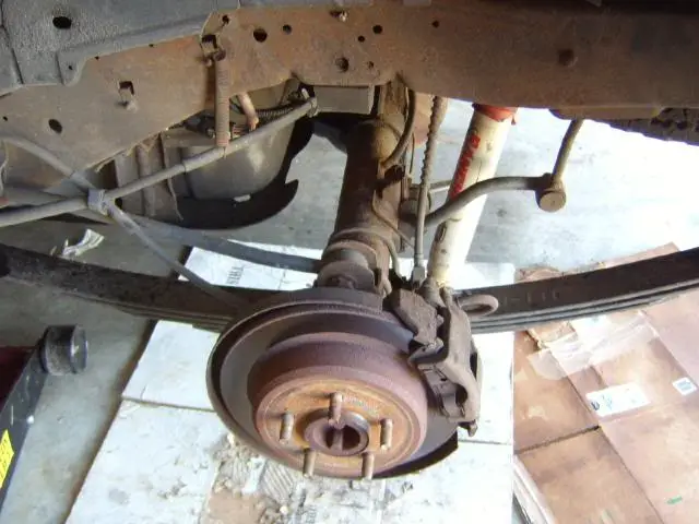

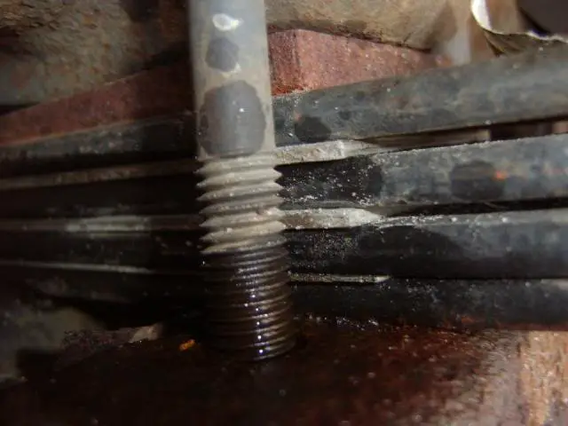

Anyway, I got the warriors installed. Who ever said that PB Blaster is your friend couldn't be more right. This vehicle spent the first eight years of its life on the South Shore of MASS and I surely was worried about the effort it would take to get the old hardware off. It turned out to completely be a non-issue.

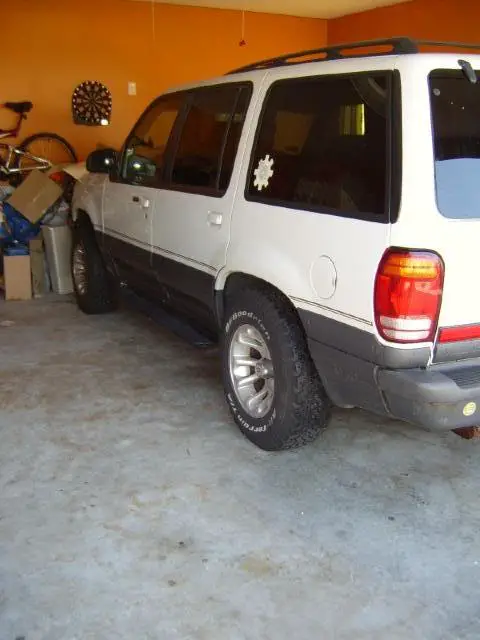

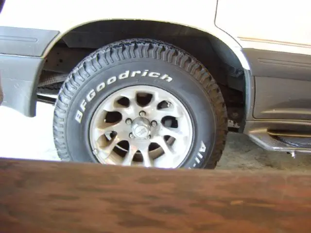

BEFORE:

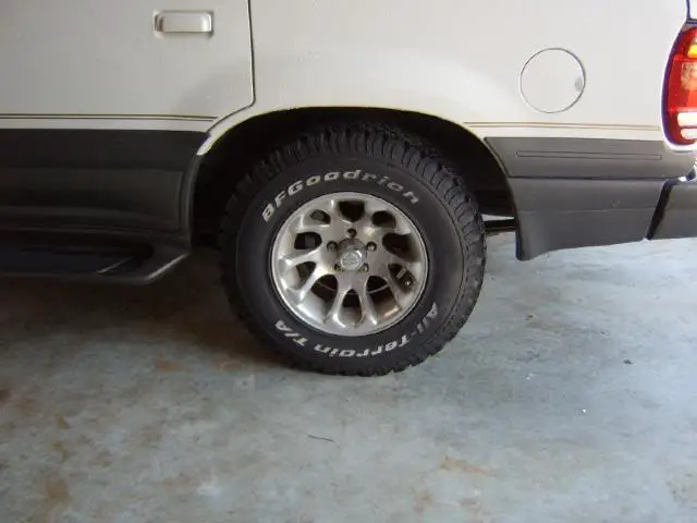

AFTER:
The pictures are not taken from the best angles and they have too much contrast but I think they still show the improvement in ground clearance. All in all I'm pretty pleased so far with the increase in ride height that came from changing out the stock shackles. Got a solid two inches out of the Warrior 153s but unfortunately the driver's side is still about .75" lower than the passenger side. The next move is add a leafs to shore up the jive turkey JC Whitney springs. I just don't think they have the proper rating for this vehicle but I can't coin up for a new pack at the moment.
