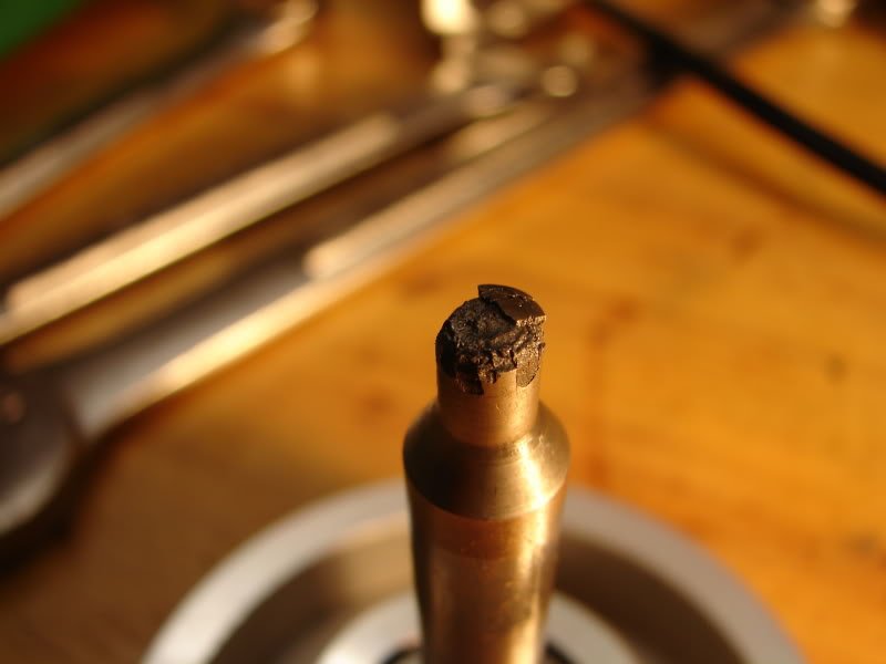

Look for the reverse servo piston for cracked pin an worn o-rings.
