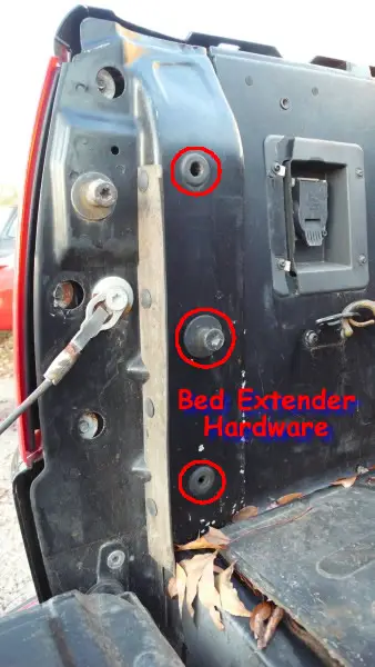

PHOTO ADDED:
The yellow circled pins are the ones you will need to buy if it is a stock ford bed extender.

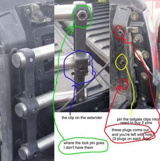

Ok, here you go.
If the middle piece has never been installed, then the hole will need to be threaded.
Exactly what I was looking for. Got mine installed today. Thanks guys.
