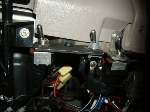

How I did it for two switches was to take a metal plate about 1-1/2" by 4", and drill holes at either end. I used a little L shaped angle bracket in the middle , and secured it under the dash to the metal part beside the hood release. The plastic cover slides right over the bolt head that is under the dash, so it hides it well.
I also just used a singler angle bracket to hold one switch onto the bolt holding the plastic piece in place....
Pic 1.
Pic 2: below.....
The bracket looks crooked in this pic, but it is straight after I tightened it down. You can see the jungle of wires that the police left for me...that is why I always tape around the + connections to my switches, I don;t want fuses blowing.
