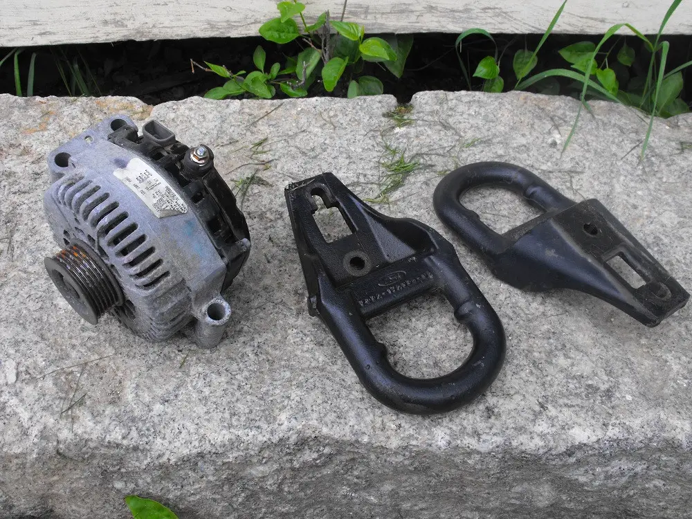

So, i got some new stuff:
i have waited and waited for months for my one local junkyard to get a truck with those tow hooks, finally i found them when i went to go get a new hood latch assembly (which ti turned out i didnt need) so i got the hooks and hardare. the 130amp alternatore i got on the last trip, still havent installed it though.

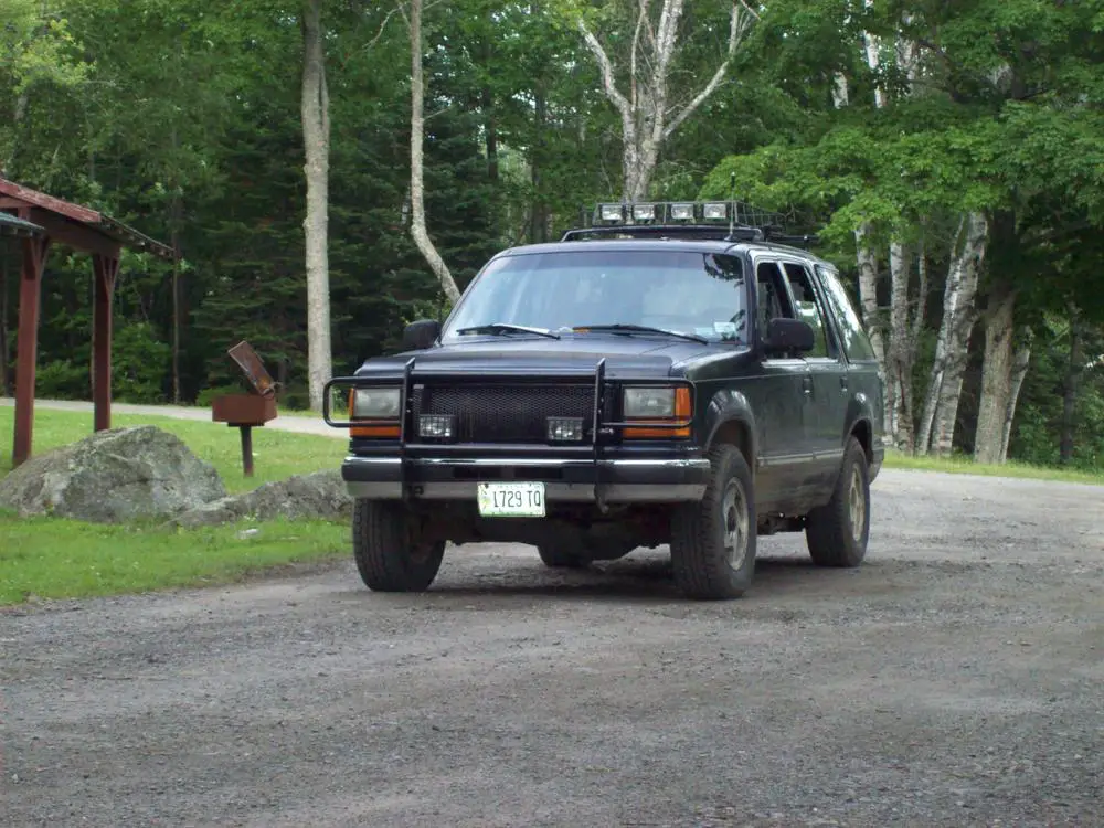

new grille, brush guard repainted
I have a thread for the grille already but i figured this should go in my registry too.
i repainted my brush guard that i did a poor job painting the first time and it was getting a lot of surface rust.
grille is all custom, all my own design, unlike usual my school shop teacher didnt decide to frig around with my designs any like he usually does haha. I think it came out really good.
double curve/convex shape is not easy with expanded steel, i was very happy when it came out as well as it did.
