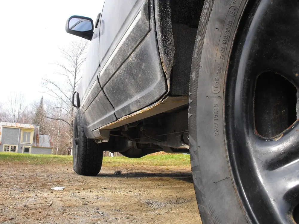

Finally have an update. So my driver side rocker was toast, I didn't have the money for a factory shaped panel piece, especially since I would also have to buy the dogleg and still make pieces for the back side. So, there was 14ga plate laying around so this is what i came up with:
This is a work in progress, I don't have much free time to work on it so it is only partially welded on, and I haven't done any of the grinding or body filler work. At least its on and keeping at least some of the salt and crap out of the upper parts of the rocker now.
I also put on my winter rims and tires, the Jeep wheels from last winter, the salt was not kind to them, and the ones pictured are the better of the four.

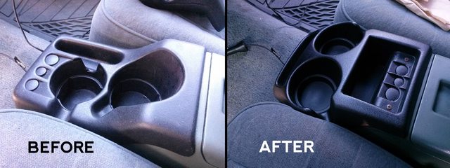

That's kind of funny what you did with your cup holders. Mine came with the newer one you have now, but it was green like my interior, and I used bed liner to make it black and stand out. But recently I took it out and found a 1st gen explorer with this cup holder, but it was gray so I bedlinered it too, I like it because the cups are now side to side, and it has two useful cubbies.
It slides right into the space the old one goes into, without modification. Our consoles already have the screw holes too:

See I had the option of getting either when I went to the junkyard for mine, and I picked this one because each cupholder was a different size, allowing a wider range of drinks in it, mugs, travel mugs, huge gas station sodas, 1L sodas, reg soda bottles, everything fits in one or the other. Works pretty good.
I've never tried anything larger than a 56oz Double Big Gulp from 7-11, but I can't really imagine why you would need anything bigger, both of the cup holders hold it perfectly fine from my experience :P It all boils down to preference though.
