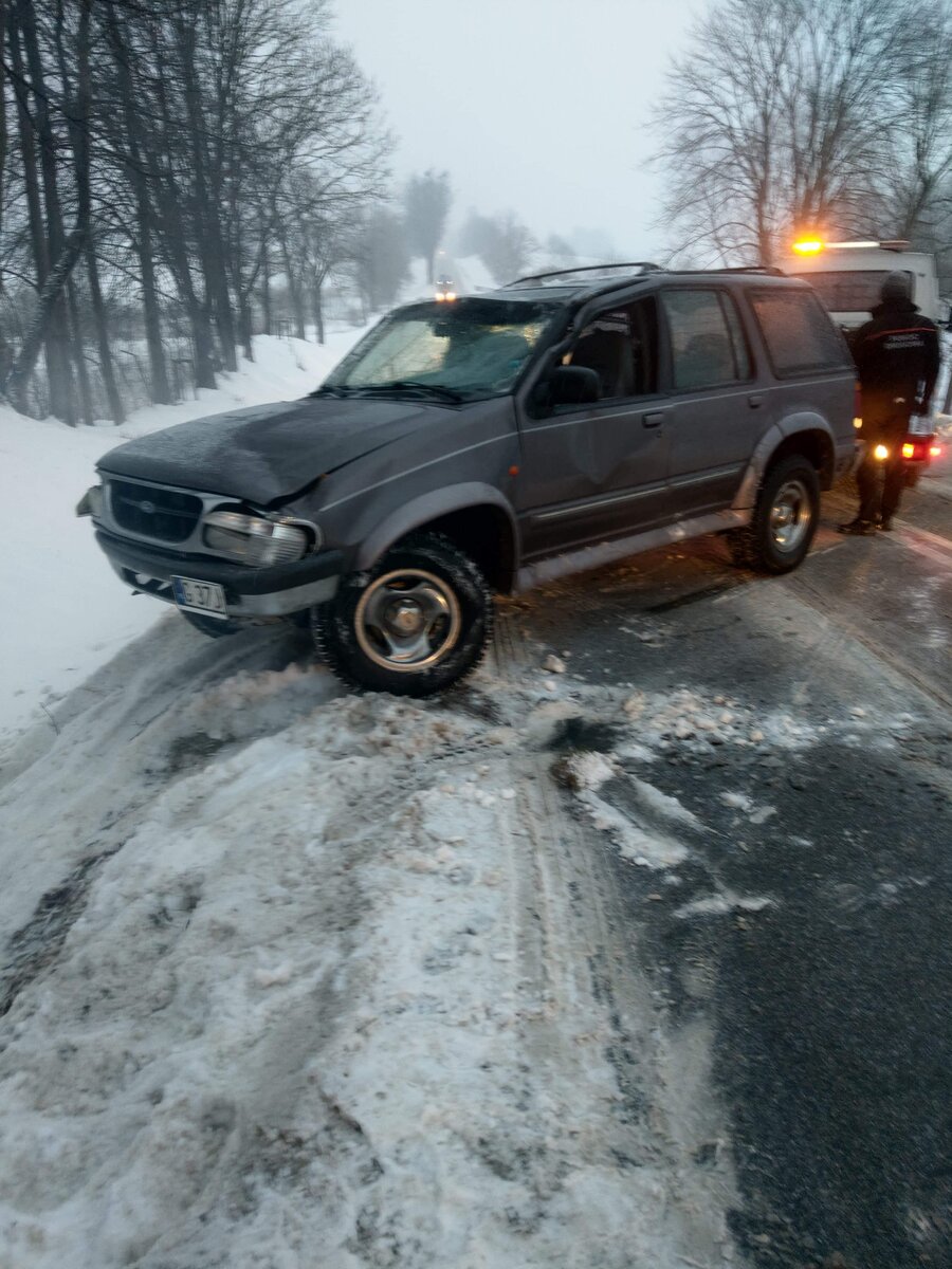

cant find perfect solution. Is the swap of body from Ex 1998 SOHC onto 1995 Ohv frame? Are they fully compatible? Is there any How to tutorial?

Pictures please!

Good thought, I wondered if it was an export, the fender emblem looks European.
