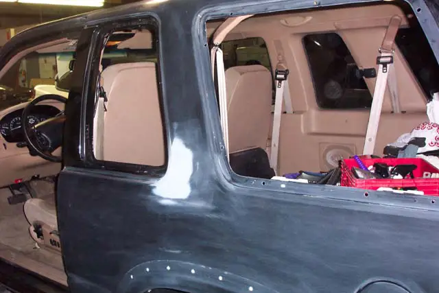

Here the Ex is totally de-trimmed. All the glass is out, wheel flare off, tail light off, rocker trim off.
( body side mouldings were removed ages ago ) With a flat sanding block sand the primer smooth with 400
grit. Make sure you smooth the edges so that you can not feel a thing.
Wipe down the whole quarter panel with thinner to remove the wax and crud.
Scuff the whole panel with a 3M red scotchbrite pad.
Blow it clean with compressed air, and wipe it down with anti static degreaser.
Dirt is even more your enemy now.
This panel can not be clean enough from here on out.
Once you scuff and clean the panel, DO NOT touch it.

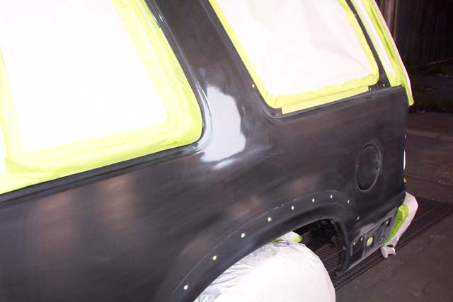

Tape it up, bag it and roll it into the paint booth. ( you all have a paint booth right ;) )
Do not use news paper for masking. It is fibrous and the over spray will not always stick to it and
the air from the paint gun will blow the dried paint back onto your wet paint. Meaning, dirt in your paint.
I did not paint the truck. The adage is body men can't paint, and painters can not do body work.
I believe this.
I also was not there for the paint process so I have no photos.

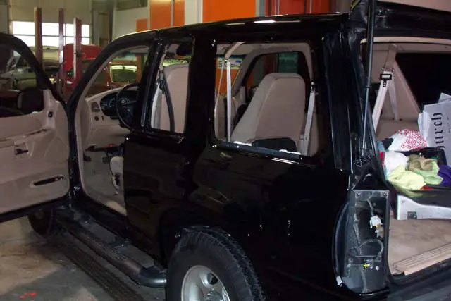

Here is the fresh painted Ex, unwrapped, untaped, ready to be put back together.

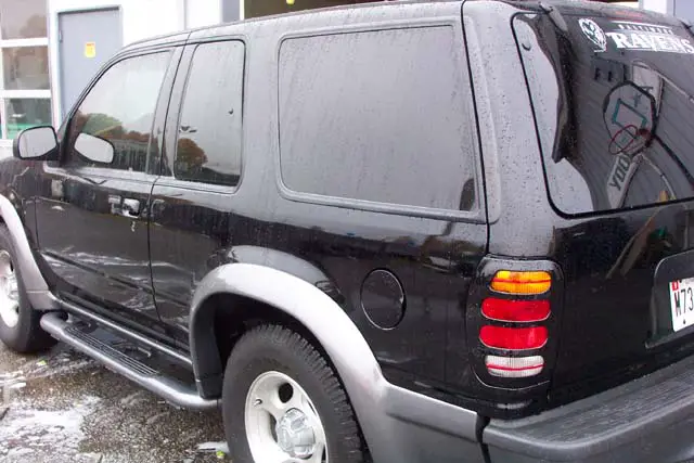

Give it a bath, to wash off the finger prints.
I hope you could follow and make sense of all this.
Different dents in different locations will present numerous challenges and scenarios.
