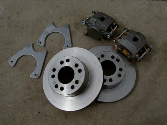

3- You can redrill your own 5 on 4.5 pattern on the 9" pretty easy. Pull a shaft out of the 9", knock the studs out, and lay a rear Explorer rotor on it (or front for that matter). Carefully mark your holes with an alignment punch (dont know the technical name for this tool) and redrill the pattern on a drill press. Go slow and use plenty of cutting oil... it will take a while. Once drilled to 5 on 4.5, you can add disc brakes easy with junkyard metric GM calipers, $12 weld on race car brackets, and rear Explorer rotors. You could have discs on the rear for less than $100.

I like James' idea if I can find out what the brackets are. So far I have not found anything. I know about the GM calipers.

EDIT: I have not found brackets per say. I think these are similar to what he is talking about. This "kit" is $240 + shipping and is not the E-brake calipers. They are $150 more for the set.
Anyone have info on the cheap brackets?
Nothing will be purchased for a while anyway, but I like to research the parts and get costs laid out in advance for each step.
EDIT 2: More sets
1. Currie for cobra (clockable). $140
2. Currie for their set. $140
3. Brackets for GM calipers. $120
