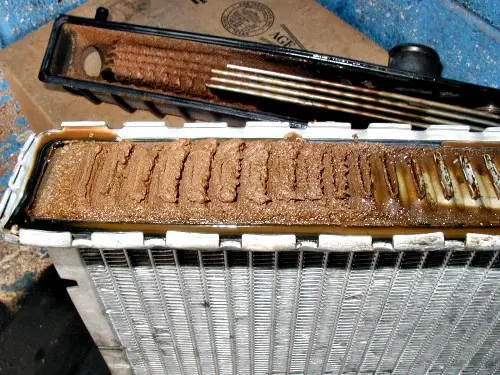

Most definitely stay away from Dexcool coolant. This isn't my rad, but mine was just as bad. I also had to replace the LIM on my Grand AM.
Thank you Dexcool. Apparantly, when Dexcool is contaminated with (exposed to) air, it becomes an acidic sludge that eats gaskets and plugs up the cooling system. It was really fun getting all that gunk out of my engine, it took 3 chemical pressure flushes to get it all.
