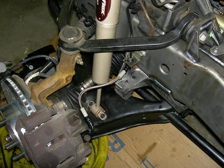

Any left/right pulling would not be from bleeding, only related if there is air in a line etc. If you did not open the bleed screw(crushed the caliper pistons), no air got in. If bleeding didn't add air, then the pulling is related to something else. Regards,
