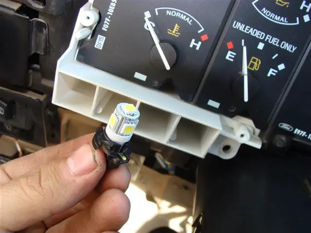

My last trip out I noticed the left side of my instrument cluster was dark so that prompted a full interior LED light swap. I ordered new LED bulbs from Ebay, 20 T10 5-SMD LED Wedge Bulbs and 1 44mm 12 SMD Loop Festoon for the cargo light.

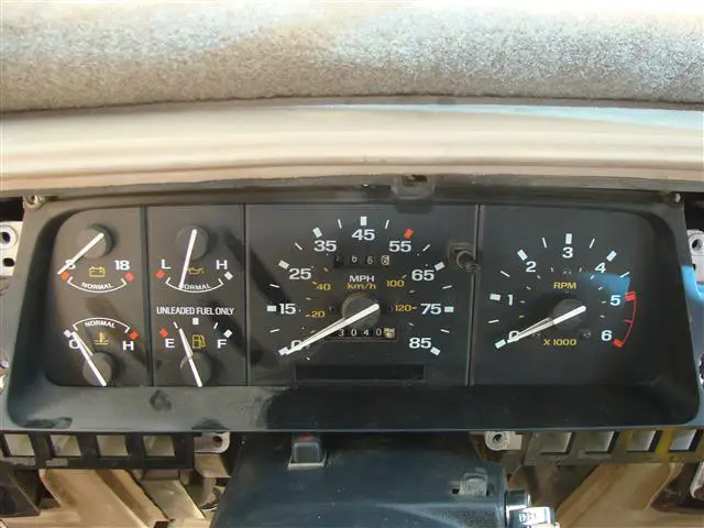

I took the dash apart and pulled out the cluster enough to get my hands in there to change out the bulbs. I took the cover out and cleaned all the dust out which made a huge difference by itself! (see the half cleaned picture below) I replaced all the cluster lights except the ABS (would remain slightly illuminated even when light goes off) and the 2 turn signal bulbs. I got it all back together then moved on to the other lights.

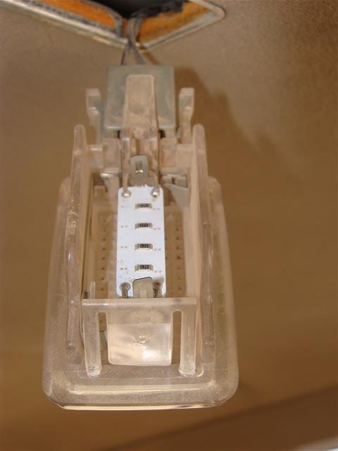

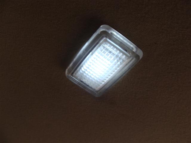

I put 3 LED bulbs in my dome and map lights and then the loop LED in the back cargo light. I also took the bulbs out of the door courtesy lights and replaced them.
The only bulbs that are not LEDs inside are now the turn signals, ABS, glove box and ash tray.
The new look of the cluster driving at night is great and the white light from the doors and overhead lights looks good too.

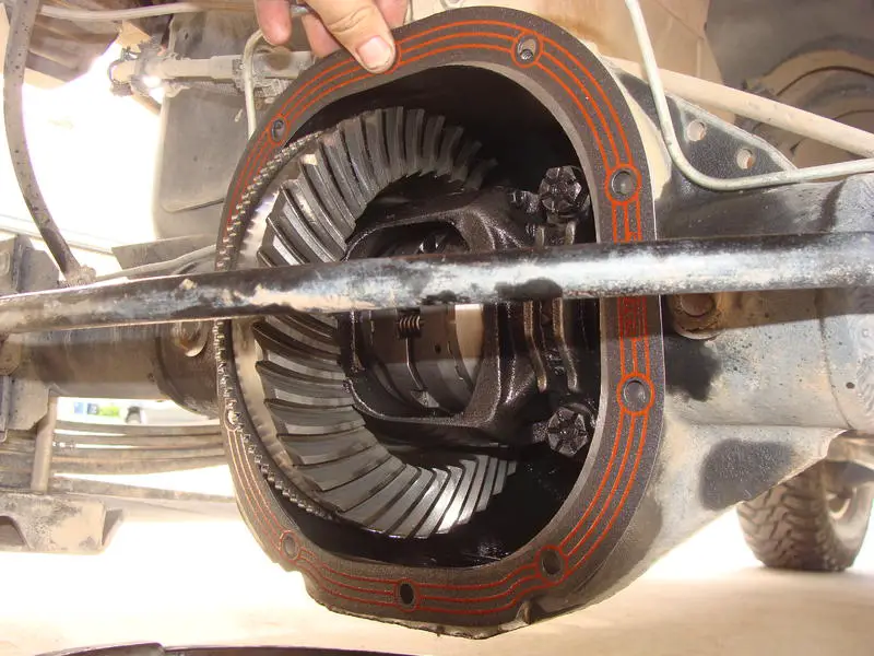

inspect rear diff and change oil with a LubeLocker gasket
