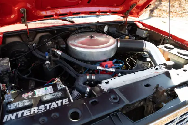

After reading this, I looked even closer at the pictures.... I don't think there is enough leaf spring in the rear to handle the abuse of a V8. The lifting blocks act as a mechanical lever to accelerate the wear. I'd probably S shape them in short time.Seller in the ad states the 8.8 is out of a 1992 Explorer, but now he just posted that it's a 27 spline axle, so Ranger. Also the pictures show its a Ranger 8.8. I don't think he knows what he has. This originally must have been a 4 cylinder Ranger to have the D28 up front, correct?
I had a reply pointing out he has the wrong axle for a Explorer, but don't want to keep messing with him.
