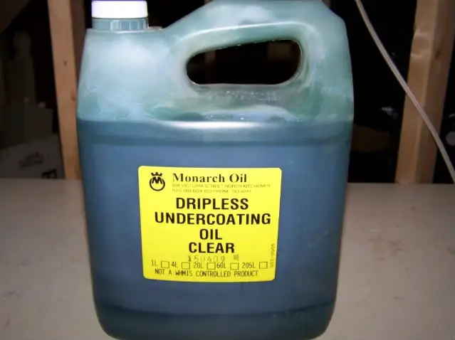

Mine still look like new at 12 years old, but I oil spray the truck each year
"oil spray" that sounds like a good idea! Then my oil leaks would blend in better to the rest of the undercarriage!:D
Actually I had an automatic undercarriage oilspray system on my suburban, the rear of the transfer case slowly seeped fluid and the universal joint on the drive shaft flung it all over the underside of the truck...it really did save the undercarriage, this was the only place under the truck that was rust free! ;)
Oil spraying vehicles is very popular in Canada. Why its not done in the USA is beyond me. Great business opportunity for someone with a bit of initiative.
I use this product. Use 2 Liters per season, and it cost about $4.50 per liter

I don't know why you rust belt guys don't use fish oil and or lanolin under your cars.

OIL UNDERCARRIAGE
In the mid 80's I bought a 1955 Dodge C1B8 job rated pickup from orig owner. It was blue, faded like old jeans. Ran like a sewing machine. Paid $700. Unheard of today.
Anyway. The truck's entire undercarriage was coated in grease and oil. Not knowing any better, I power washed it all off. Was horrified months later when I saw everything underneath getting rusty. Learned a good lesson then.
MORE ABOUT OIL UNDERCARRIAGE
Something to think about, or perhaps a question. If a vehicle underside is rusted already and one coats with oil, any moisture inherent in the bottom side will be trapped and unable to evaporate. Guess the oil cover job ought to be done after a number of dry days.
On the other hand, trapped moisture has gotta be less harmful than a winter of road salt and wet slush packed into every crevice under the vehicle.
J If a vehicle underside is rusted already and one coats with oil, any moisture inherent in the bottom side will be trapped and unable to evaporate. Guess the oil cover job ought to be done after a number of dry days.
Oil is usually hydrophobic so the moisture would move away from it.
