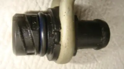

They're broken, so the PCV won't twist and lock into the Valve Cover.. I cut a strip from a Nitrile Glove and wrapped it around the PCV to make it more of an interference fit but it's not really a fix.
Is there a work around for this? Is there an old school Grommet that will fit so I can use a standard PCV?
The reason this came to my attention is because I began to smell burning oil. I found that it's leaking a bit of oil down the Valve Cover onto the Driverside Header..

"Yeah man, the pins in the VC are gone. It's smooth in there so there's nothing for the PCV to lock onto.
Mine does not have a heater. I'll have to check it to see if it's held since I did my quick fix.. Will report back."
But I checked, and it's still holding pretty tight for now!
I have a ziptie holding on the nitrile piece where the heater goes on other models. It's in there..
