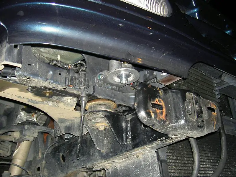

this is my setup, i have removed the stock fogs but the relay must be somewhere still... i may try and wire it up using that relay and go buy ANOTHER switch...but i think your right, a relay is the only way to run these, even if its running with what it came with
Very good, you can add the lights with the OEM fog light pigtails. Do you have the old fog lights? There is a plug at the base of each side of the radiator support, facing down. The fog light connectors plug into those. The fog light switch on the dash controls those.
The inboard connector is the ABS, the outer connector is the fog light.

yea, i disconnected them (they were useless), wrapped the wire ends up in the bumper, and i now have my roof light switch where the stock fog light switch was....
