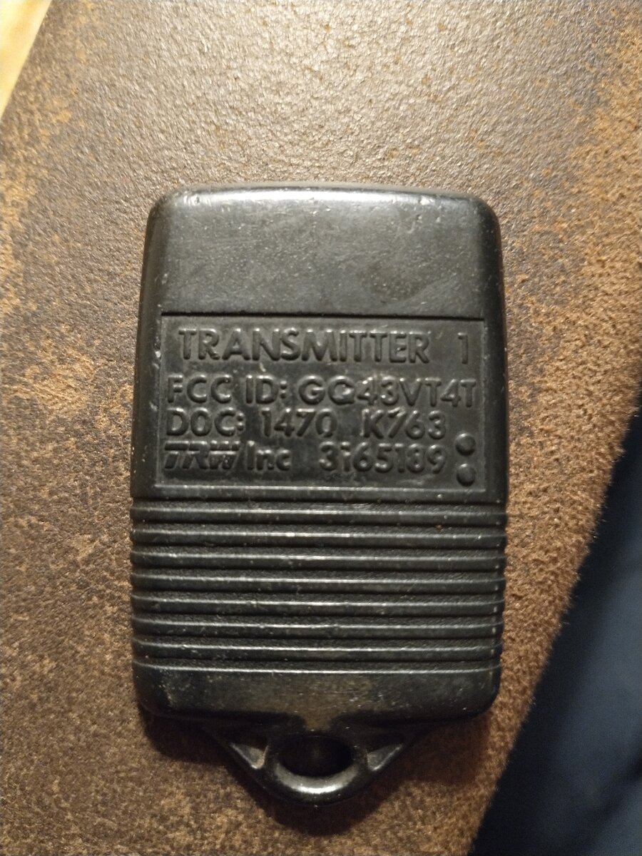

I haven't had these systems working for several years now. Im hoping it will hold and continue to work for a while. I may try to match some new ones to my working fobs and try them too. The numbers on the case on my working fobs are presented in the attached pic. Check these to yours. Maybe you have a mismatched fob?
