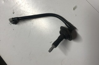

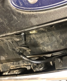

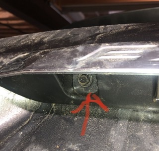

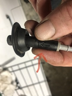

I had the same issue and ended up deleting the check valve. It couldn’t be cleaned. Here are some pics to help others. The 4 bolts under the Explorer chrome trim price get removed and the trim piece snaps out. Start at the outside edges of the trim. I found it easier to unhook the washer tube at the lift gate first. The I could disassemble the rest.
