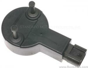

2000 4.0 OHV. I have started removal of my upper intake manifold in order to access my camshaft position sensor. The Hayne's manual says its at the "rear of the block where the distributor used to be on these engines." I've read on this site that for this engine you need to take off the upper intake manifold for better access to the sensor. But I haven't found a detailed thread for the 4.0 OHV. I can't see it with a small mirror, will it be obvious where the sensor is once I have the upper intake manifold off?
Thanks
CMP photo
According to RockAuto below is what you're looking for.
That looks like the replacement I have to install, just wondering exactly where it is.
it is at the rear of engine, a little toward the passenger side. It is in the flat area of the rear block deck.
Follow the wire harness back there and that may help you find it
