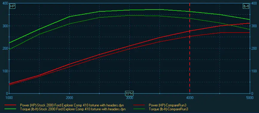

Was everything stock other than camshaft in this example?
I would say the upper rpm power numbers are a bit high with the restrictive stock exhaust manifolds and muffler. I ran another comparison, this time the stock X with the cam VS a Stock X with the cam, small headers, and better flowing cats, muffler(s), and pipe(s). This is a great illustration of how restrictive the stock exhaust can be.
That’s showing like 350 hp lol heck yes
