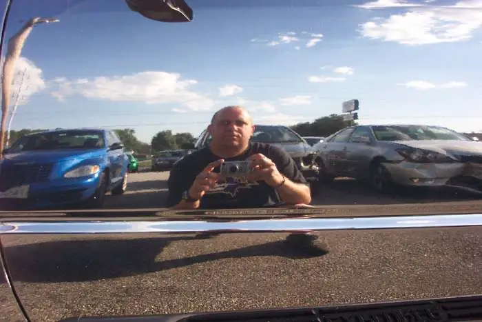

I use zaino products for the rest.
A bit costly but you will never go back.
Thanks for chiming in. Your pic looks almost like a mirror!

thanks. I use my door every morning to brush my teeth and comb my hair. :D
