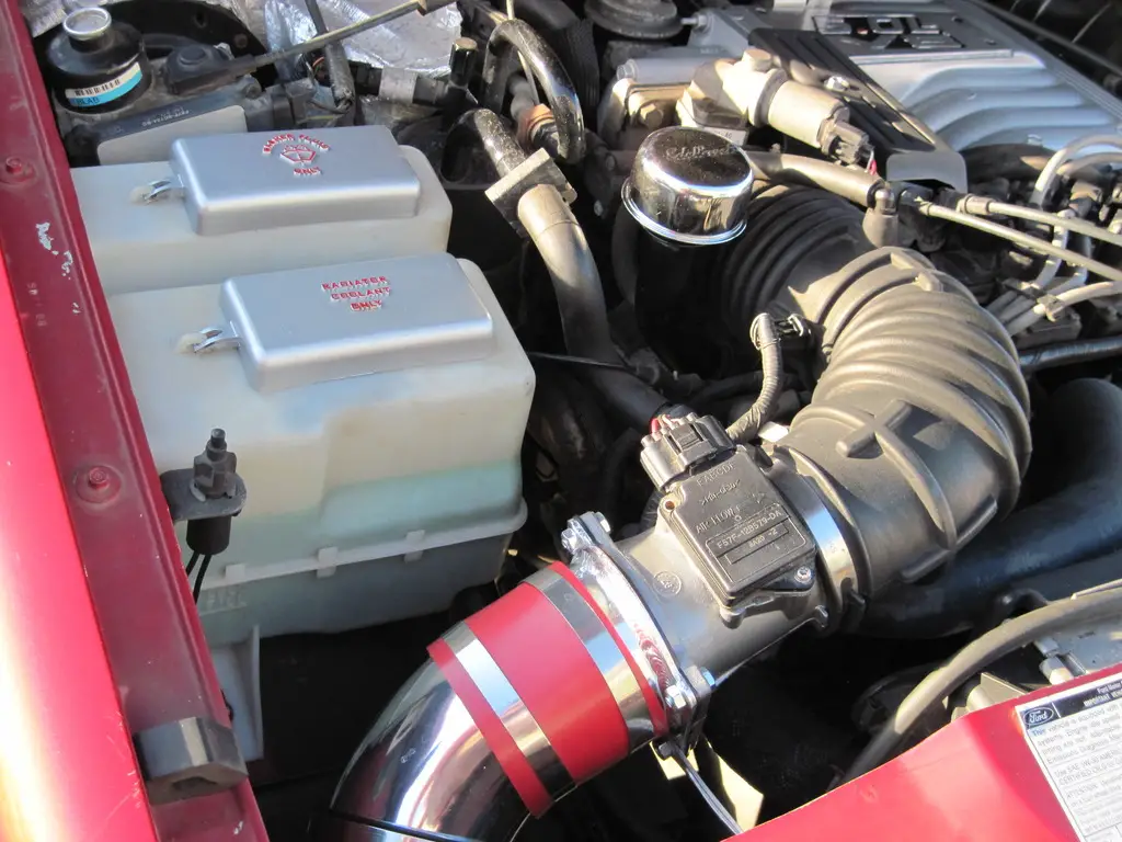

Looks nice, but I think the chrome oil cap is probably not a good idea. The engine's crankcase needs to be sealed for the PCV valve to work correctly.
I dont know what to tell ya man.I have had that breather on for 3 years now and nothing has happend.I have no air pressure that comes out of that filler at all.No check engine light.It literally changed nothing for 3 years.It looks cool tho.
