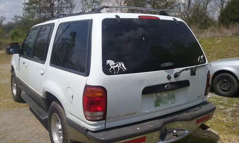

I also splurged a teeny bit and picked up a couple little horsey decals for the back. I really like how they look on the back glass!

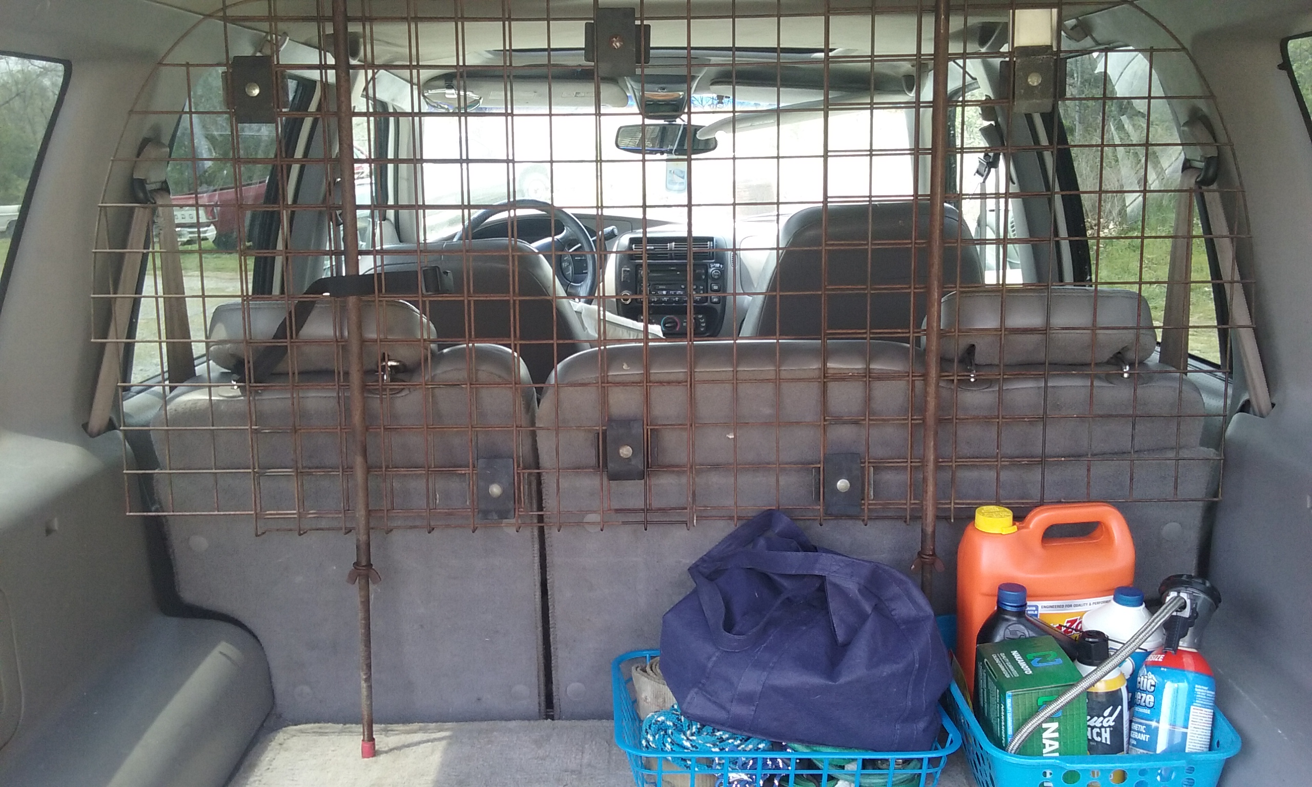

Then I pulled out the pet barrier I have been carting around, the supports were rusted solid and I hadn't had a chance to fix it. I took a bunch of liquid wrench to the two supports, sat on the barrier part in the trunk of the 'sploder, and took a pair of vice grips to wiggle the supports out so I could install the thing properly. Came out really nice, I think!
