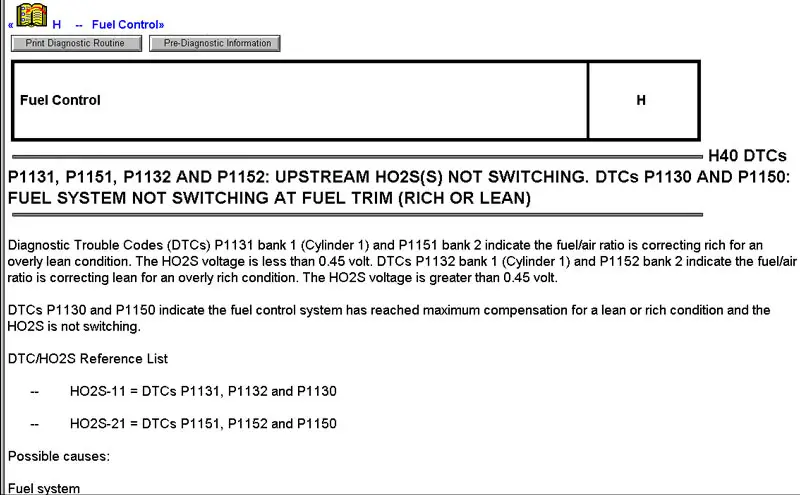

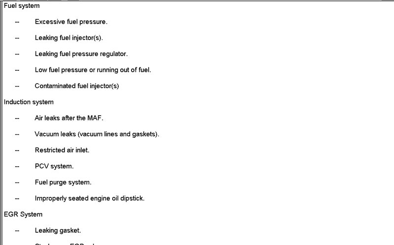

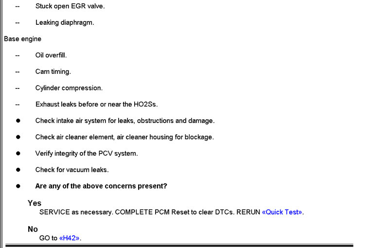

I went to AutoZone and had the code read. It showed 2 codes,both the same--P1131. Can anyone tell me what this code refers to?

If you are back home.... and the code situation does not repeat, I'd not worry about it. It did not sound like it affected the performance (driveability) of your Ex. You were in an extreme situation there and the PCM will throw a code on anything likely to exceed 1.5x mandated emissions. You GROSS polluter you. <g>. If it continues let us know, otherwise do not worry. I fret not a lot on non driveability codes.
Happy Exploring
Chris
Thanks to everybody for the information. I'm glad I can ignore it.....as long as it doesn't repeat in normal driving.
