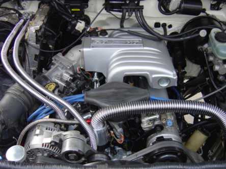

When I put the new longblock together I went ahead and Painted all the parts to make everything look good. Here is a pic of what it looked like once it was done....
I will take some pics of the exhaust and my lengthened front driveshaft as soon as I get it back in a couple of days. I will also take a little audio/video clip of it with my Digital Camera and get that posted on here as well.:eek:

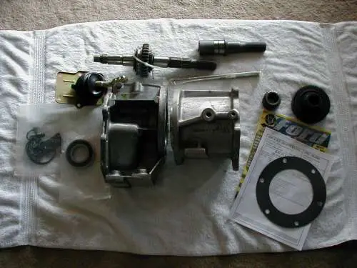

Thanks alot, I havent been on in a while but this is a great suprize, Im nearly done with mine, im real close to ordering the adapter now for the t-case,
I have a question on the measurements for the correct adapter, Where do you measure from the block where the bell bolts up?or the trans where the bell bolts up to the back and then where the t-case is? to the t- case?
here is a picture of the Adapter pieces
This 2 Piece kit REPLACES the entire back half of your stock world class T-5 tranny. The first piece you see in the picture there is the new tailshaft housing which replaces the old tailshaft housing and shifter. This piece is the same length in either of the 2 choices for length on the kit.
This piece measures 5 7/8" inches long. Now behind that comes what AA calls the Adapter itself. This piece comes in two different lengths. This is how you keep the stock locations of the transfer case which also keeps the driveshafts the stock length. Now I do have to say this is sort of hard to do BECAUSE it also relies on engine placement. If you dont have the engine in exactly the same place as the stock engine, in reference to where the bellhousing bolts up, then your measurments arent going to matter. This is exactly why I ended up having to lengthen my front driveshaft even with the shorter Adapter. I placed my engine so far back that it didnt matter.
So what I Recomend doing is just buying one then bolt everything together in the truck before you do your engine mounts permanently. This will allow you to adjust it so that it comes out right for your needs. Remember there are many variables to this.
If you want to get some kind of reference than here is the answer to your original question......
-Measure from the very front mounting surface of your STOCK bellhousing to the rear of your STOCK tranny JUST BEFORE the transfer case. This will give you the overall dimension of your stock Tranny.
-Now You can measure the length of the Stock T-5 tranny from the front of its bellhousing and only measure to the rear of the GEAR BOX itself! do not include the tailshaft housing because this will be gone later. Mine measures out at 16" This will be a little different for 94-95 trannys because the bellhousing was a little shorter I believe. Anyway with that measurement you can add the new tailhousing piece which will be as I said earlier 5 7/8" inches long.
-Now comes your input... Purchase the longer or shorter adapter to meet your needs based on the overall length of your STOCK transmission that used to be in your explorer. Remember that you are trying to match as close as you can the overall dimensions to keep the Transfer case in the stock location as well as your drivshafts. I cant remember exactly what the two measurements are that they sell but if you call them you can find out easily. I hope this helps and Let me know if there are any more questions.
