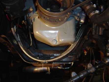

These feed and return lines follow the engine crossmember to the driver side frame rail where they continue toward the fuel tank on the inside of the driver side frame rail.... This looks like it is touching the oil pan, but it is not , for anyone who was wondering. :)

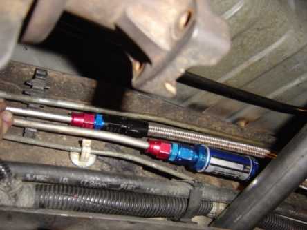

So after the lines go down the frame rail they meet the stock lines coming from the tank. I cut these lines off behind the stock fuel filter where they are hard lines.here is 2 more "hard line to hose end" fittings. On the FEED line there is an inline filter installed.
