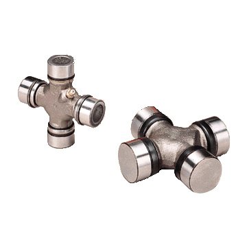

It could very well be a dry or worn u-joint on the rear drive shaft
u-joints are not the same as the slip joint
this is a u-joint
