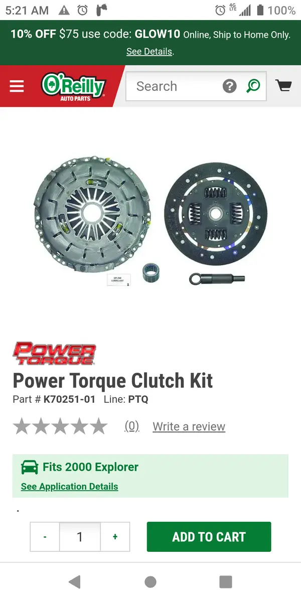

Do you know what brand of slave they put in? Luk and Motorcraft are the only ones to use.
Power Torque brand.
Took into transmission shop this morning. They could duplicate the difficulty shifting into gears. Pumping the clutch pedal (or killing engine, shift, and start engine as a backup plan) will get me by.
They said it was the master cylinder going out. Shop owner asked where I got the parts, told him O'reilly's and he said they're reliable. I use their First Call program where major parts half the list counter price.
