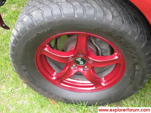

Do you mean that little lip you are supposed to use to jack up the vehicle?
BTW - the only place mine rubs on is the swaybar.
Sorry for the large image size..
Im confused as to what "lip" you are talking about. Is it the one in FrankRizzo's pic under the sway bar? What is that for?
it is on the bottom of the lower control arm facing rearward. if yours isnt rubbing there then there is no reason to trim it.
Well I dont have the cobra R's on yet. Is it the horse shoe shaped piece that is about 2"long
From what I can tell all explorers were built a little offset to one side on the frame. That is why they rub on one side and not the other. All you need is one spacer on one side because they ussually only rub on one side. I run my x with out a spacer because I never turn the steering wheel all the way lock because it is bad for the powersteering pump.

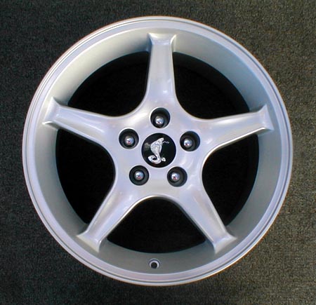

Hey Big Poppa! I ended up getting Silver 18"x9" Cobra R Replica's from eBay. They wheels are high quality and came perfect! The seller was moore9911 if you want to do a search for his auctions. Awesome to deal with, and the wheels came fast. They DO have a +24mm offset though (about 1 inch), so unless you are getting a 255-55-18, you're gonna be rubbing. Well, hell, you'll probably still be rubbing! :p
But, I do agree with 98FordX24 about the GeFracing site. If you want to go with 17 inchers, that was the best deal I could find, too. Hope that helps!

No problemo.....I paid $672 for the set of 4 plus $80 shipping. For a grand total of $752. That's $188 a wheel shipped, and a pretty good deal I think for decent 18"s right to my doorstep! Keep in mind that they are 9 inches wide with the +24mm offset. I think most 18 inchers are 8.5" wide, so check your clearance. I am going to try out a set of spacers from performance wheel and tire. A little spendy I know, but I'm dying to try. :D

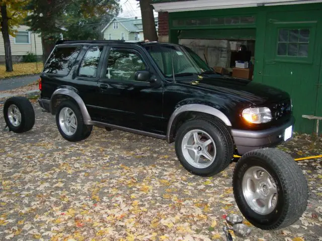

Got my tires mounted on the 18" Cobras today!

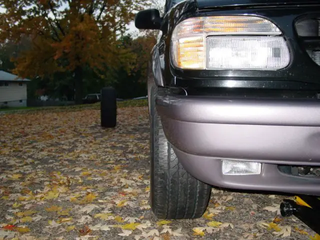

Hey Guys, whaazzsssuuup?! The other day I took one of my front tires off to just check fitment of the new 18"x9" Cobra R replicas (+24mm offset). Turning from lock to lock, the wheel cleared everything just fine. BUT.....it was very apparent that with a tire mounted I was going to be rubbing on the front sway bar. This didn't give me 'warm fuzzies,' so I decided to have the tires mounted and check clearance again.
Got my new 275-55-18 Michelin Cross Terrains mounted today and my suspicions were correct! I can turn the steering wheel with stockers on it two full turns from center to lock in either direction. Now, I can only turn the wheel about 1-1/2 to 1-3/4 turns before the steering wheel stops because the tires are hitting the sway bars.
I will be ordering some spacers with lugs from Performance wheel to go all around, as I originally planned. But I am still trying to decide what thickness to go with. 1" will return the wheel offset to center and eliminate my problem, but I was thinking if I'm gonna do it and spend the money, maybe I should go with 1.25" or 1.5" and widen the track a little bit and give me a little extra clearance between the tires and sway bars.
Here are some pics, so gimme feedback as to which size spacer I should go with 1, 1.25, 1.5" THANKS!!!
Here's a pic of the front straight on so you can see how far the front tire/wheel sticks out.
