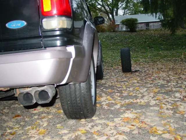

Got my tires mounted on the 18" Cobras today!
Here's a pic of the rear straight on so you can see how far the rear tire/wheel sticks out.

Looks good! I'd go with 1.25" spacers. Oh, lower it too! ;)
Hey Chris! Yea, sounds like a good compromise to go with the 1.25" spacers.
Oh and I'm a little embarrased to admit this especially the way the truck looks in the pics, but I already lowered the front end a little over an inch! :( Left the rears at the stock height just because it looks level with the front only lowered. See I have the single rear leaf spring and it already had a little ass-sag, so I figured I'd leave that alone.

go 1" spacers in front, and 1.5" in the back. ever noticed how the front track is wider than the rear? this annoys me, and if i were to get spacers, i would do it to help get rid of this.
HA!! Portable tire disposal unit! HAHAHA!!! :chug:
The wheelbase length in the front and the rear should be the same. I'm kinda wary about putting different sized spacers on the front and the rear, because it may affect the 4x4 when turning. And, the rear tires just look 'sucked in' because the fender flares stick out more in the rear.

no, its not cuz of the flares. it is because the front is actually wider than the rear. it is that way on all of them, just like the 94-98 mustangs. mine has no flares, and i can see it plain as day. different size spacers will not affect anything with your 4wd, or AWD for that matter.
when you lower it 2" like mine and others here, it makes the front track even wider, due to the fact the A arms are "swung out" more. (i cant explain it right, just imagine it in your head.);)

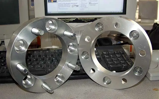

I stole this picture from one of Rick's threads, but this is what the spacers from performance wheel and tire look like. They aren't just cheapo spacers, they are pretty heavy duty with their own lugs.

YO, just got my spacers today from Performance Wheel. They look exactly like the ones in the picture I have posted above, except I have 2 - 1" and 2 - 1.25" for the front and rear respectively.
I plan on putting everything together on Saturday, but am debating how to treat the spacers. Aluminum does get a tarnished type of corrosion over time and that'll look like crap.....especially after all the money spent on them.

Note on the spacers from Performance Wheel and Tire: They do fit very well and the machining work is top notch, BUT they kind-of use a standard size outside diameter, so they are larger diameter than the front rotors and just about right to mate up with the rear rotors. Before I install them, I am going to turn the spacers on lathe 1" smaller for the ones going on the front tires.
