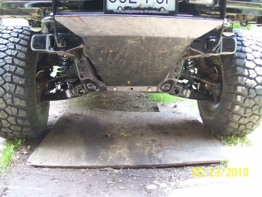

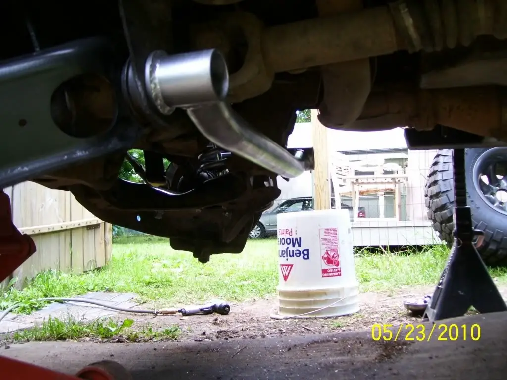

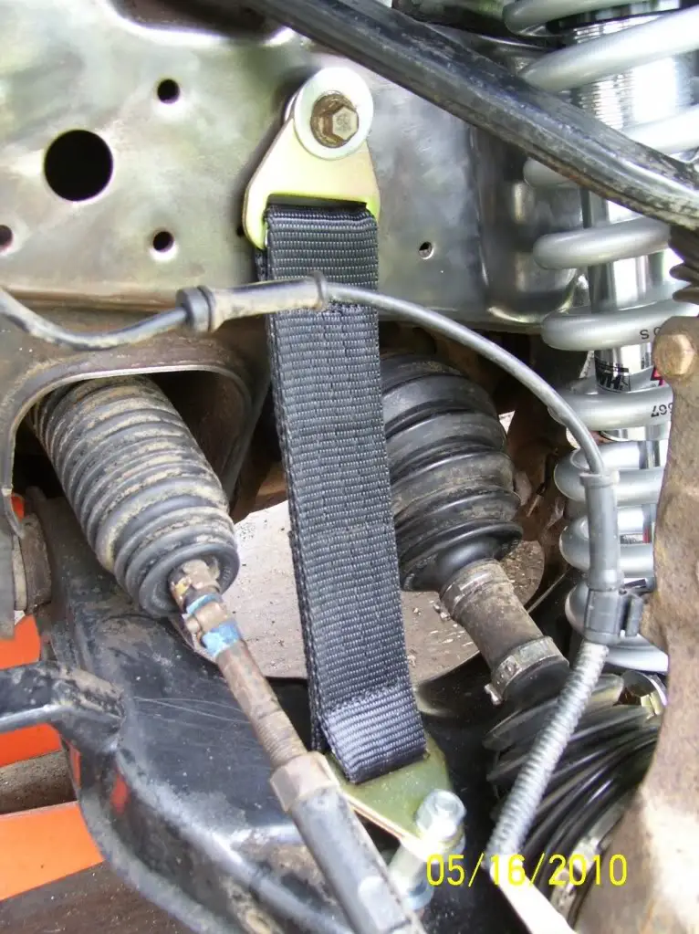

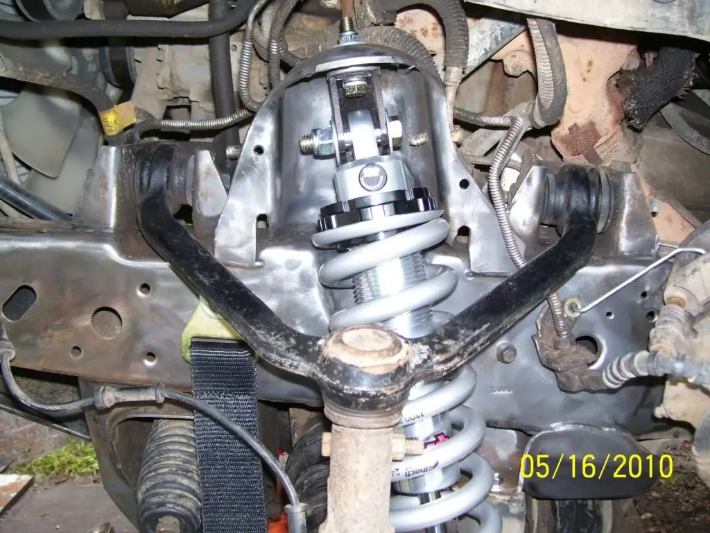

PM gmanpaint
He done Torsion Bar to Coil-over conversion with a brilliant way, on his 94 Black Hole
http://www.explorerforum.com/forums/showpost.php?p=2464056&postcount=423
http://www.explorerforum.com/forums/showpost.php?p=2468091&postcount=435

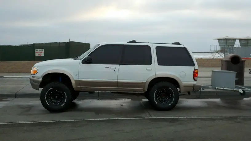

here is a pic of my truck now for reference:

with the RCD kit, the only welding required were gussetts for the shock tower. The actual upper and lower shock mounts were bolt-on.
