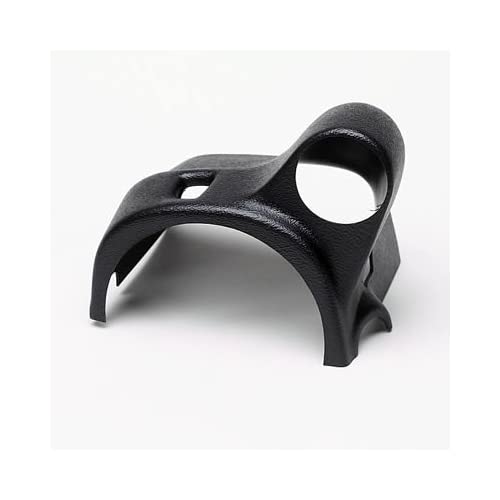

So I was digging around and comparing pictures and have an idea. Obviously it's well known the F150 Autometer column pod will fit our trucks.
From the pictures and knowing how Ford like to share columns between models, I think the Autometer pod for 94-02 Mustangs would fit too, but only for those of us lucky enough to have a manual tranny.
I couldn't find any threads about it, anybody using one? I like the gauge position better than the F150 version.

I found it on summit, I think I like the f150 one better personally.
What is that little half moon on the right hand side for?
Dont waste your money on the Mustang pod. I pulled the column covers off my '94 Cobra and matched them up to a spare GenII column. It would take quite a bit of custom work to fit it.
Good to know, thanks for posting.
