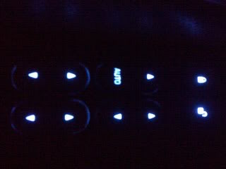

window/locks
45 min - an hour for all of them.. all of them except the drivers door are really simple.. i just swapped out the leds and swapped in the correct resistor when needed.

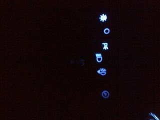

headlight controls
20 min - just had to take it apart and swap out the incandecent light with a green cover (which was 6v if i remember right) for 2 leds in series
then for the fog light it was a simple led/resistor swap

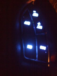

steering wheel controls
30-45 min.
realllly tricky i actually had to drill holes through the pcb and slide leds in them as there is no room to put them on top of the pcb and the voltage of the current lights is off too much...ran 12v from a pin on the connector

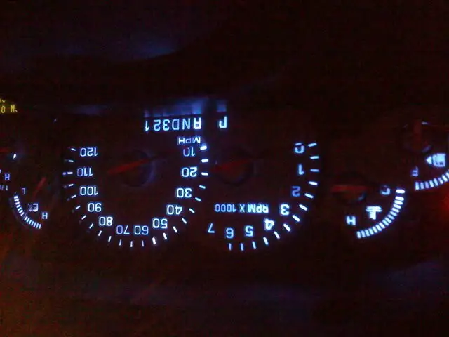

speedo etc
ok the big one everyone always wants to change..
prob took a few hours but no more than 4 id say ( i did it over two days)
i had to take the needles off the guages and pry off the guage face which is one peice and glued down.
now the lights of the speedo are white its a tint that makes the numbers green...so i took a sander and sanded down the green parts (but left the red ones ) to make em clear. then i replaced the lights behind the speedo with a led/resistor (they are 12v)
now i got an uneven distribution of light which i fixed a little with som etape but its still a litttle noticeable..im eventually gonna try and put some blue film behind them to even out light distribution...but it still looks better than the green i think.
i know all this sounds like a bunch of gibberish but its easier to explain with pictures...maybe ill take it all apart again when im off next week and do a writeup

dicided to go snap some pics with my phone so here she goes...for some reason they look more white than blue but thats the pictures...theyre actually a reallllly nice deep blue
lights with kcs off
with kcs on
(with just fogs on its a blue led)
ill try and use a better camera so you can see the blue better
