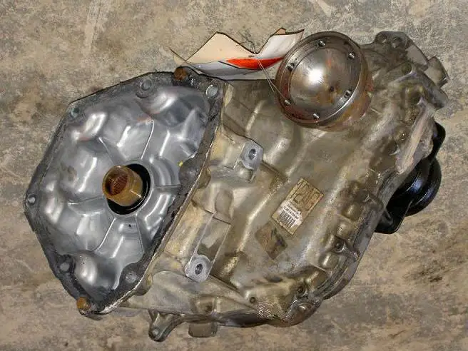

I just glommed onto a 2005 Lincoln Aviator Luxury for $1500. I've read up lots on the transfer case and its infamous viscous coupling. What other transfer cases for this vintage of UN152 platform fits and works in an Aviator for A4WD operation, rather than AWD, so I can get rid of my viscous coupling? I'm looking at things like the BW4405/6, which I know will need its own control module and the push buttons for the dash, but can I just swap its control module in place of the TOD control module of the stock Aviator? Or would I need to graft the A4WD control module between the stock control module and the TC by some Frankensteinian means?
Full disclosure, I'm only going to be a Lincoln Aviator owner temporarily. I bought it for its drivetrain, which I intend to modify and graft into a Crown Vic/Grand Marquis to make a 4WD, 4 wheel independent suspension Mercury Marauder-alike.
The AWD units are plenty strong, the only possible problems are idiot owners who allow the tires to wear unevenly(which is what ruins the viscous clutch over time). The BW4410 AWD you have is likely as good as the prior BW4403 and BW4404 that came out in the mid 90's. The viscous clutch may be the same unit, they are a sealed component. If the fluid becomes black, that is a majority of the time result of the viscous clutch leaking out it's fluid(and the clutch material with it).
The A4WD models all have a special GEM module for that 4WD, plus the TOD and 4WD modules. You could likely fit that into the Aviator to make that work, but for a drivetrain swap, I'd consider something else.
The trans in the Aviator is unlike prior Ford transmissions, the transfer cases are different. So the TC's you may use will have to come from other 2002+ Ford models, I only know that AWD model 4410 name. They all have very large mounting pads that attach to the trans, below is a picture of a BW4410 TC.
BTW, the AWD TC is smaller than a 4WD TC of any kind, not a lot but some. That will matter if you are trying to fit it under a car. Personally I would choose between a 4R70W trans, or a 6R80 six speed, which both have aftermarket controllers available.

TOD works via PWM of electromag clutch on input shaft of trans case. 4x4 High is attained via 100% duty cycle to clutch. The shift motor only function is range select to move shift fork in and out of low range. The clutch sees 100% duty cycle in low range as well.
02-03 model years used a Motorola 4x4 Control module for TOD transfer case. 04-05 switched to CANBUS as well as using pcm and instrument cluster in place of 4x4 control module. Gen 4 went back to seperate 4x4 Control module.
Auto 4x4 on 02 and 03 used input and output speed seensors to determine front and rear driveshaft speed differences and apply varying duty cycle to clutch for 4wd. The move to IVD, or Advancetrac coupled with RSC got rid of a rear diff mounted VSS and moved to a more complex monitoring system via 4 wheel speed sensors. Two front integrated tone rings in unit bearings (on all U152s) and two rear tone rings on outboard CV wheelend. IVD also made way for an additional sensor and different master cylinder and ABS HCU for control of braking system to assist moving torque side to side for traction in addition to an induced chassis upset mode to maintain yaw stability in a calculated "rollover" incident. This locks up one or more wheels momentarily to induce a significant yaw and stabilize chassis.
A few other notes, 02 and 03 4.6L were not drive by wire for throttle. 04 and 05 added drive by wire (throttle control for stability and traction control), As well, Advancetrac with RSC added a gyro for stability control at center pivot point of vehicle for yaw measurement in addition to an electro-optical sensor with trigger wheel to measure steering angle.
For 4wd, Certain calibrations used less than 50% duty cycle to electromag clutch even in 4 high and when engine load and driver calculated power demand increased, duty cycle would increase. It was determined differential wheelspeed calibrations were too sensitive in certain 04 and early 05 MY and so a reflash was broadcast for "false 4x4" engagements typically seen with steering wheel at lock and throttle applied low speed.

The transfer cases all have full time connection to the driven end, RWD up until the 5th gen Explorers which were FWD unless the TC engaged the rear.
Those TC's with an electromagnetic clutch, that is simply in line for the output shaft for the front drive. There is no differential in the TC's, no locking function of such a diff. The rear is always driven, and the chain runs the forward output shaft, in the left side position under the driver. The AWD viscous clutch is in that section, as is the electromagnetic clutch for the A4WD TC's.
Yes. I'm talking about replacing the viscous coupler with a locking diff, among other mods, that would otherwise maintain the 2005 Aviator transfer case's exterior and function, but I'm doing my thought experiments based on a tear down of an Explorer TC that appeared to have no external connectors whatsoever, so I'm probably thinking badly. I need to wait to see what is actually between the frame rails of my Aviator when delivered to know what I actually have and then know far better what route I should take to get to where I want to be, which is an A4WD. If that means major mods to the TC I get in my 2005, so be it. If that means the wholesale replacement of the TC and supporting electronics, so be it. Even if it means a reflash of the PCM to keep it from wigging out when it doesn't see the stock TC control electronics.

You will trouble with the transfer case, because none of them are made with a diff, or an arrangement that splits power like a diff. I'm not expert, but what I've read makes me believe they all have a primary power path, and a chain that drives off of that, to the secondary path. The clutch of some type will always be on the secondary path, so all you can do there is control the application of that one output(front drive in this case). I think you will be choosing a TC based on it's overall size, to do what you can with that.
