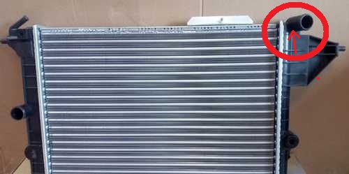

I ran into this on an Opel Vectra. I didn't see any problems. Couldn't find a leak. But I pressed one of the flanges and antifreeze flowed out from under it. The crack was right under the flange. When pressed, heated, vibration, the crack became wider. Antifreeze gradually flowed out and immediately evaporated. i marked it in red.
A coolant pressure tester would find that leak
