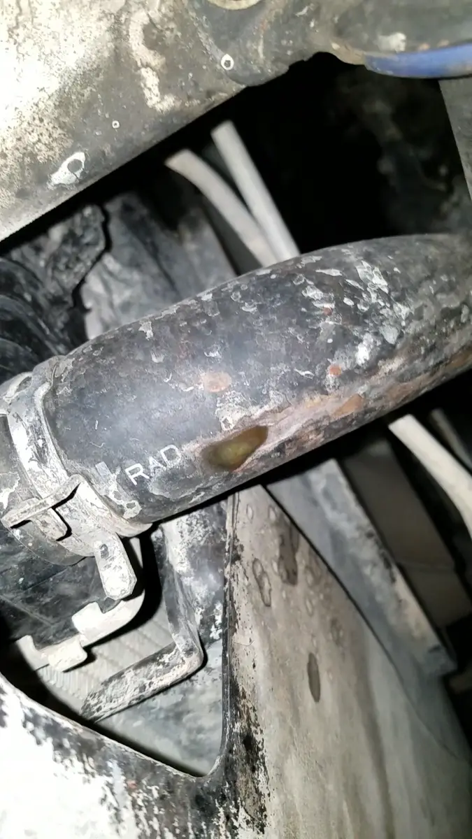

So I've know that I had a few minor leaks since I got my Explorer last year. I just recently replaced my valve cover gaskets and cleaned up that minor oil leak. Now I have a coolant leak that seems to be getting worse. I had thought it was this hose here
This is on the bottom driver side of the radiator and runs up to the water pump I believe. But tonight i looked under the vehicle to see if it was leaking and I find this.
The pulley picture is the crankshaft (I think, it's the lowest center) as you can see it has a ring of wetness around it along with wet oil and gunk? And above it you can see that there is rust/residue aswell. That would be the bottom of the water pump correct? Would this indicate a leaking water pump? Any ideas what it is or what to check? Water pumps are cheap so I'm not worried about replacing it. I just didn't want to yet unless it was needed. Coolant drips down that hose in the first picture and also end up in other regions like this trans line.

Coolant looks like its from the waterpump seal.
Also the last pic could be the front main crank seal weeping (or maybe the pan a tiny bit too). Mine wept a bit too, but with Pennzoil platnium 5w30 High mileage it seemed to have stopped.
I think you have the OHV, I replaced my WP many years ago. It had play in the shaft, maybe check for that.
Yeah at this age I'd just go ahead and replace the water pump if it hasn't been done in recent years or thousands of mi., unless you see coolant higher up like maybe the thermostat housing is cracked. You can go to some trouble instead to cover electrical items then rinse coolant residue off, then blow standing water away with compressed air or even a leaf blower, get it completely dry then watch for new leakage with it idling in the driveway, but if there's a lot of coolant around the water pump then I'd just make an assumption.

I already pulled and replaced my water pump yesterday. Painted the new one ford blue (except for the inside and other contact areas lol). Put it on and let the RTV harden overnight. Filled her with tap water this morning to take the lady to work. Hooked up my obd2 and opened up torque pro on my phone. My X took forever to warm up (longer than it use to at least) and then it'd go down to like 180 at times and others up to 200 which was worrisome because I could have swore she always ran at 194 flat with the old pump. (What's your OHV run at?) Dropped her off and on the way home it's doing good and stay at 188-197 until it slowly creeps up to 200 and then suddenly 240. So I turn the car off while it's rolling (I've got the 5r55e) and put her in neutral. Only I put it in park, the parking prowl ratchets and I think I just blew a belt until I look down at my gauges and I'm in park so I quickly shift to neutral and roll into a local restaurant parking lot. I get out to look and there doesn't seem to be any leaking other than steam from the radiator cap. So I let her cool down and drive her home. Doesn't overheat again. Reaches like 202 at one point and went back down again. Soooooo. I'm thinking I'll replace the thermostat because I don't know what else it'd be and I'll run some radiator flush through the coolant system. Hopefully the parking prowl didn't mess up my transmission. I'm worried about it but she drove all the way home and shifted from 1st-2nd fine so let's hope. Thoughts and opinions appreciated. How worried should I be aboutilized blown heads and transmission issues, which are my deepest worries? Edit: Also the old water pump had an audible turning of the pump so I'm sure that's a source of some noise. Currently I'm to worried about problems so everything sounds bad. "Is that a new noise?!" "What's broken?"
