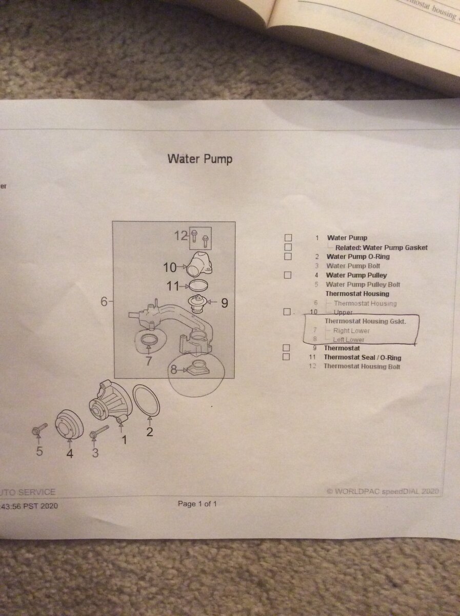

I just replaced my Thermostat . The engine is running 20 degrees hotter. Now my thermostat housing gaskets are leaking. This diagram calls for parts 7 and 8. I have not found these parts in the engine cooing section of the service manual.
Auto zone was able to sell me part number 7 and orlies was not much help. Next stop is NAPA tommarow morning.
Ford wants to sell me the whole manifold assembly (part #2L2Z9424AB) for 460 dollars which is a last resort. Does anyone have any experience doing this job?
Please see attach d pictures.
