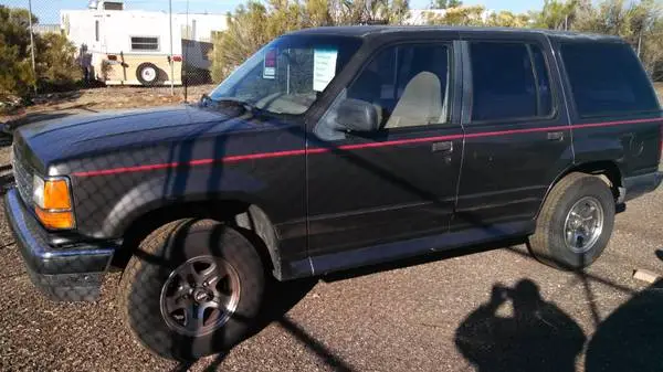

There's a real peach 4dr 5speed down here in Arizona.
Charcoal grey with red pin's. Clean; No rust.
Manual hubs, manual transfer.
108K, headliner is toast. It's a desert thing.
All factory. No conversion here. sweet!
$1600
Think it's gonna be mine next week.
I'm looking for a donor.
But it really needs to be a 94' Limited.
I will likely resell this one, if I get it before it gets snatched up.
MrCribb;
I can sit on it for a bit if you are really interested. You can fly out and drive it home.
