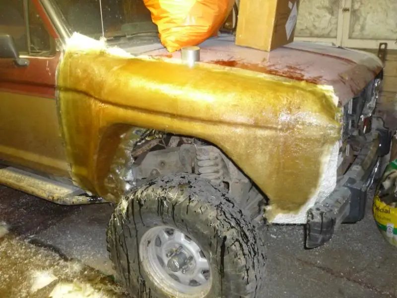

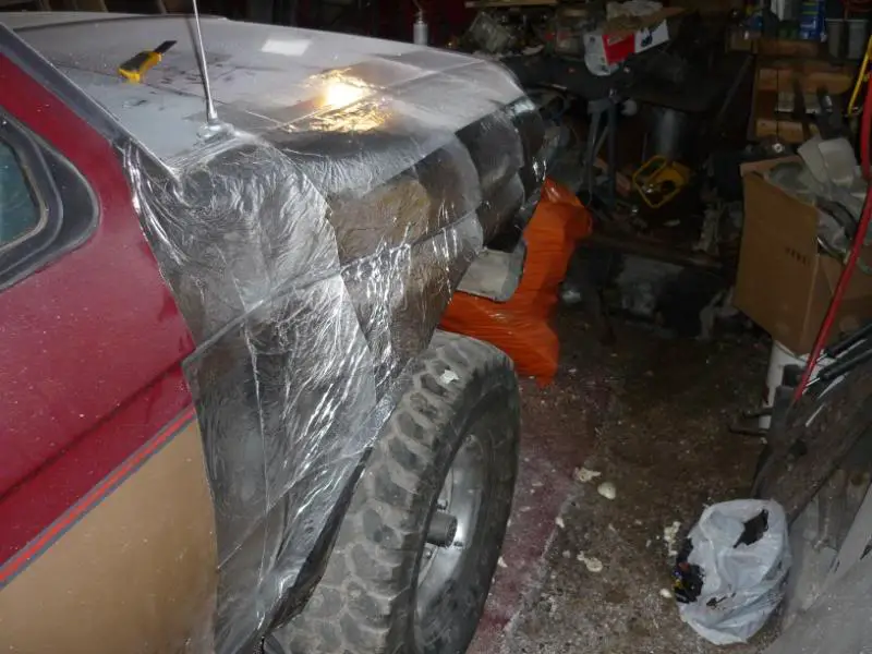

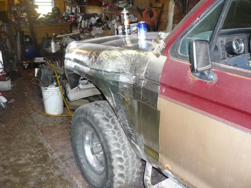

Only update for today is I got the passenger rear wheel well opening shaped and covered it in foil. So all the foil is on and it's time to start glassing. Picked up 2 gallons of resin and 20 meters of chop mat. Going it start glassing tomorrow. Need to make up a roller tomorrow at work, and grab a few brushes.

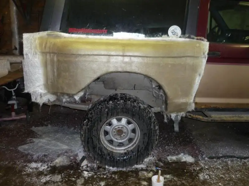

Not sure how I plan to cut the rear. I'll likely just cut the tub and transfer that line to the outside skin. Trim the original fender till I can fit the glass quarters on. Going to have to pull the interior side panels off and make sure that the interior is sealed to the outside.
Am I looking forward to it?? Hell ya! I've been waiting for this to come for a long time.

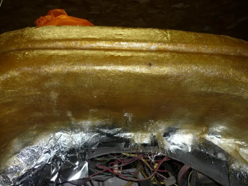

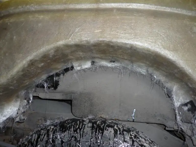

I got one done in 4 layers. Fawkin gallon of resin for one. Slight miss calculation. What a PITA to do in the wheel well. Once I pull them off I'll run another couple of layers to thicken them up. They are in the path of flyin debris.

You probably already know of this but just in case, there is a release agent called PVA (polyvinul acetate) which epoxy does not stick to. It can be rolled on but preferably sprayed (you can thin it out with [I think] acetone). PVA is available in most boat/marine shops.

Ya I know of the PVA. I have some but I didn't want to use it. Bad enough that the first layer of glass didn't want to stick to the foil.

#2 done. I used a different resin I had as I'm left with only 1 gallon left that I bought the other day. I've got about 2 gallons left from about 3. It was just over half of a 5 gallon pail. Now I have 2 left to go. will be doing that tomorrow.

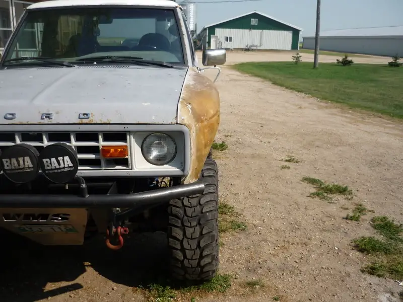

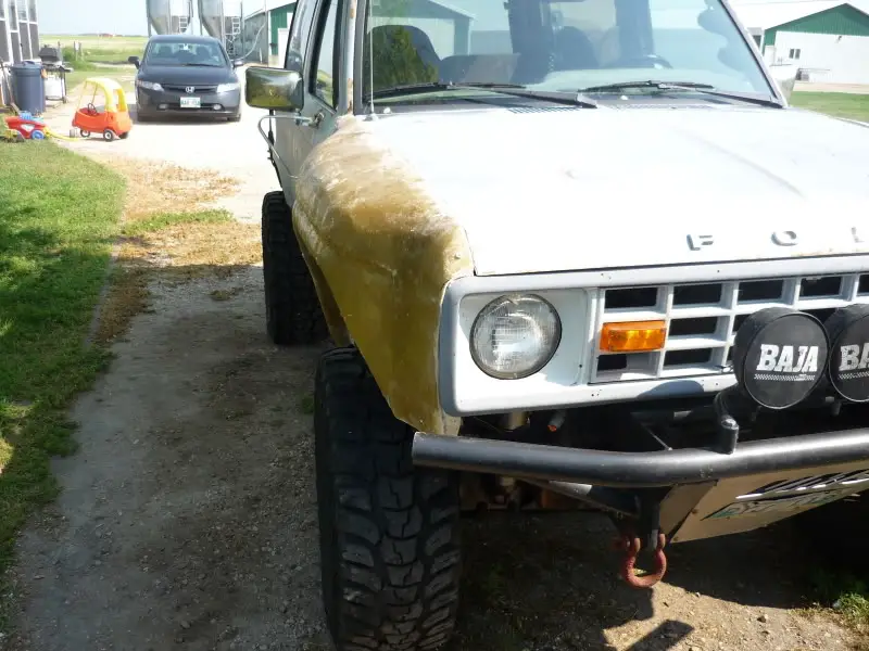

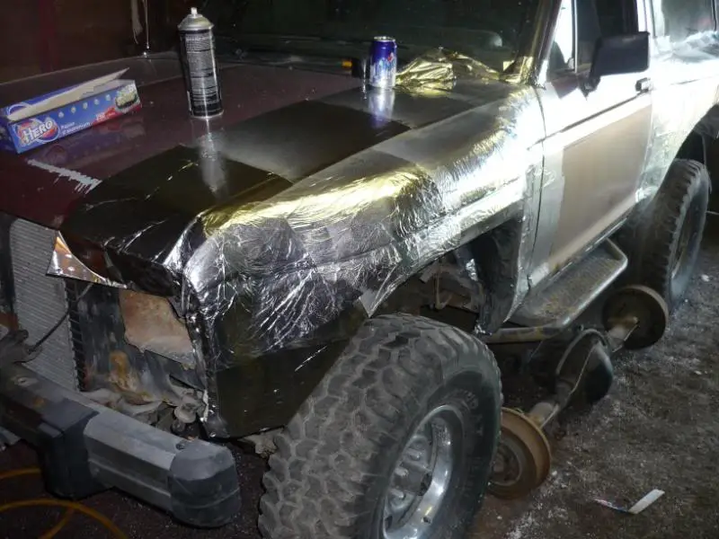

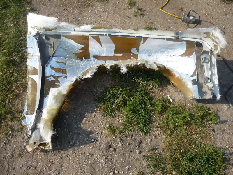

Drivers side front

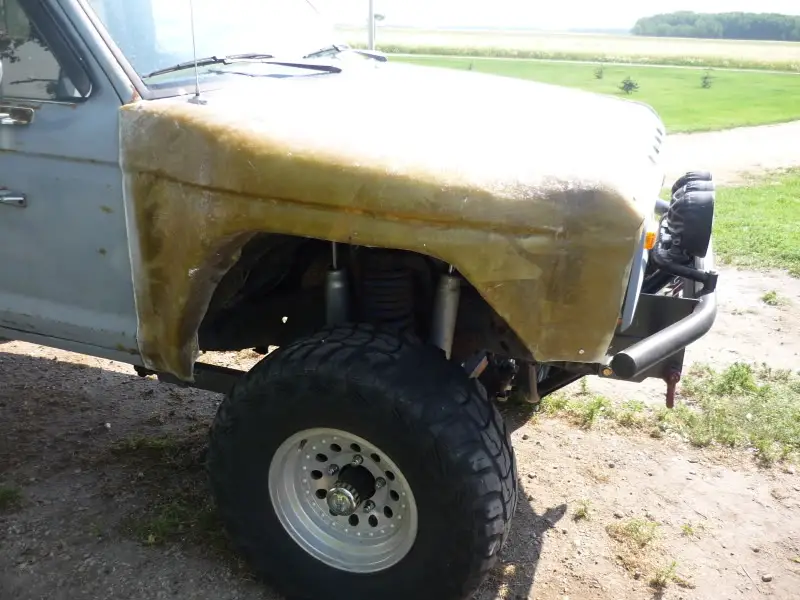

Drivers front with Fender frame.

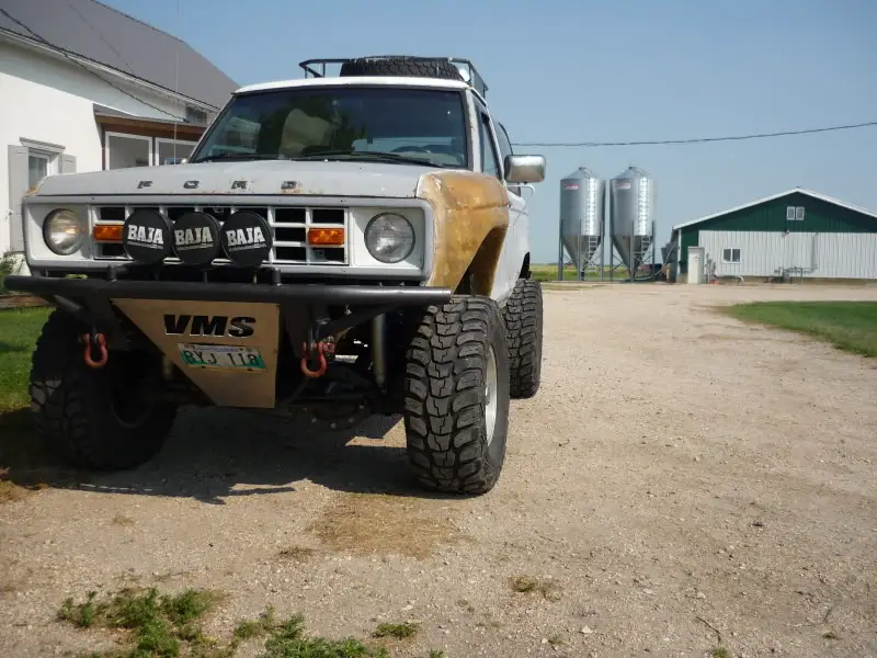

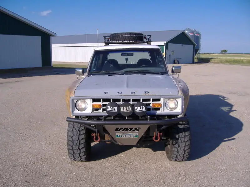

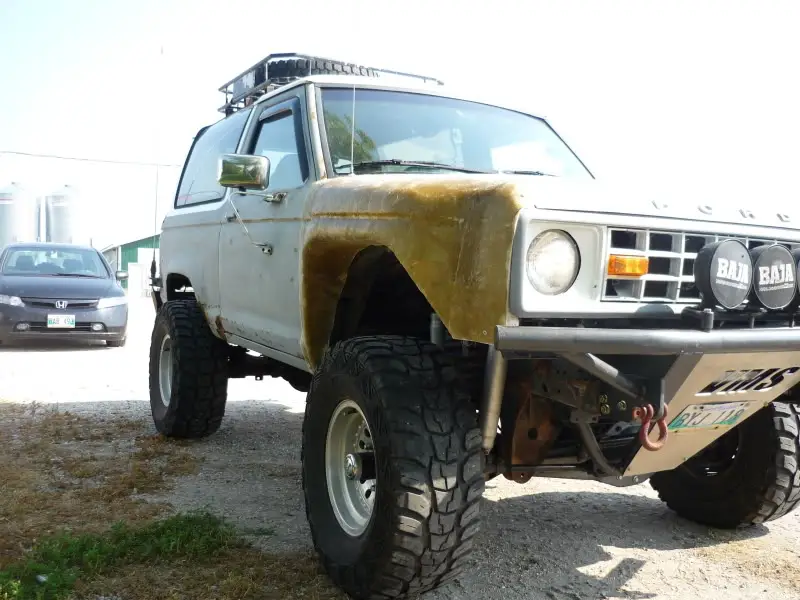

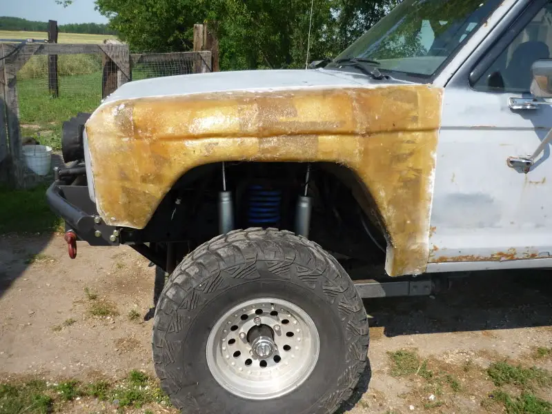

Rough Trimmed and mounted the fronts.

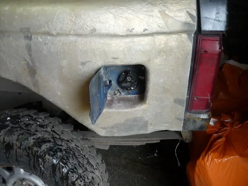

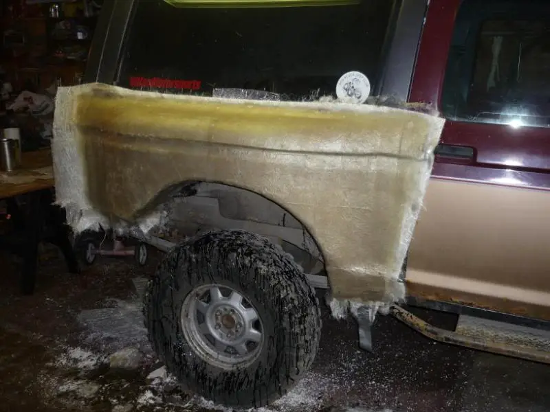

Finished up the last rear quarter panel last night.
