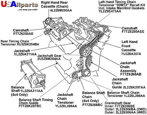

I don't know anything about the Advanced parts, I just ordered the 00M12 kit - $48.39 + shipping from Tasca Ford in Cranston RI. The Ford part # for the kit is YL2Z-9E473-AA. While researching the part #, since the parts guy said "00M12, What's that?" I came across an image that shows various timing parts and their approximate locations along with their part #'s. I couldn't paste the image but I googled "Ford parts 00M12" and the fourth result down was this : USAllparts.com - Ford [00M12] Timing-Chain Tensioner Service Kit ... Accessories & General Parts ... FO-EX245MFIE-00M12 Print product data
I think it's a european website so it's not the place to get the parts unless you're there, but the image is good. Someone more computer savvy could do it I'm sure.

That is the image Rudy602 was referring to.

I used the part numbers from the picture above, they were still good.

OE Part No.: XU3Z6K254BA / 7U3Z-6K254-A Rear tensioner
Recall / Service Kit # 00M12 / OE Part No.: YL2Z-9E473-AA
OE Part No.: 4L2Z6M290AA Right hand cam casstte
OE Part No.: 1L2Z6L266AA Balance shaft chain tensioner
OE Part No.: 7U3Z6A257A Left hand cam cassette
OE Part No.: YL2Z6L266AA Jack to crank chain tesioner
OE Part No.: 2L2Z6K297AA jack shaft to crank guide
OE Part No.: F77Z6710AA Upper sump gasket
Total cost for these parts is $288 and no problem with shipping to the UK
