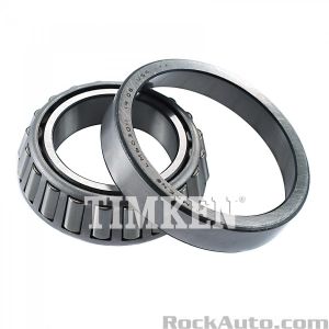

I'm going to be switching out my front wheel bearings. Both inner and outer on both tires. I want to get Timken's and as far as I can tell, mainly gathering my information from rock auto, Timken's set 37 is what I need all around for my 92 sport 4x4 with manual hubs. Can anyone else confirm this?
Also, can anyone recommend a good set of rotors with the racers already installed?
Thank you!
I just replaced mine along with other parts a few days ago. didnt get timkens as i couldnt find them locally, used instead National A37 i believe, inner and outer where the same, bearings came with races. No issues so far and im running 35" tires
Thank you for your reply! I've looked up the National's and the specs do match. So I'll be ordering the Timken's. I know there is a well written guide on here for replacing the bearings but I am curious if you had any tips, tricks or solutions for and problems you ran into.
It’s pretty straight forward. I always order new seals and use a small block of wood and a mallet to drive them in evenly.
What @Blue m&m said, dont forget the wheel seals, other then than that its pretty straight foward. ive taken mine on and off a few times now (have a 93 ranger with auto hubs) and manual hubs are the easiest. Follow the write up in the how to section and you shouldnt have any issues.
Yeah seals are on my list also (Timken 4250). Im not to worried about getting the seals in correctly. Mainly just getting the spindle back on correctly. I know about the 20foot/20inch torque rule but I always second guess myself in situations like that.

Solid in the rear independent in the front. I'm not sure about the solid axle but the front independent axle bearings aren't sealed in the way I believe you are talking about. You have to pack it and seal it up yourself. The bearings come to you like this:

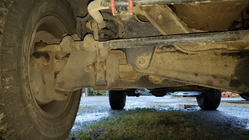

Man I am really confused by this now lol. So I just snapped a pic for you. To my knowledge I should be able to change out the bearings pretty easily without slicing anything. I am definitely not a machanic and only work on my own vehicles but maybe there is something I am missing.
Dirty I know.
Dirty I know.
@Alex8706
OK! Now I get it! They used the "Twin-I Beam" suspension as used in the 4X4 trucks! This diagram shows you all the parts. Clearly, the bearings are seen as they are separated from the brake rotor. So, yes, there is no problem at all replacing individual bearings if one is bad. It is never recommended that an old used outer race be used with a new cone and roller assembly, or vice versa. Sorry I created all the confusion. I just had no idea the twin beams had been used in any Explorer. imp
Dirty I know.
You access both the inner and outer bearing by pulling the rotor. The inner bearing is located in the back of the rotor and is held in with the seal. No need to do any work from underneath the axle.
Is your truck lifted? The tie rod geometry looks a bit out of wack. If so, that is easily corrected with a dropped pitman arm.
No, not lifted.. How is it suppose to look?
Generally, it should be dang near horizontal and in line with the axle. That provides the least bumpsteer and makes it easier to align.
