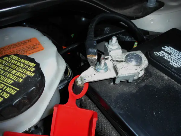

This is really confusing. I have a 2016 Explorer Limited and this is what the positive terminal looks like, after a cleaned it up a little:
But the part everyone else seems to have looks like this:
I only have 2 wires going to the positive terminal. The one on the left is crimped on, and the the other is bolted on. That 100 amp fuse attaches to a big flat connector at the bottom but I can't figure out what wire is supposed to be fused. Should I just get a simpler battery terminal?

The link in post #47 seems to be what I have on the end of my cable.

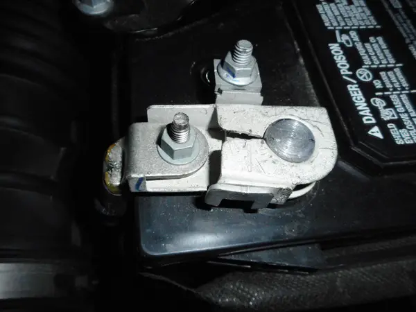

Hi Peter,
If you look closely at yours, I'll bet the second of two wires (the one coming up vertically from below) is actually crimped to the battery clamp itself(?) There is no mounting lug like for the upper horizontal wire. Mine has clearly been altered so I can't go on what mine looks like.
The photo I attached below is closer to what I think ours is, but with an extra mounting stud. I'm afraid that the two flat flaps at the 10 o'clock position is used to crimp this clamp (and our single stud version) to the vertical wire. This requires a special (and likely expensive) crimping tool. Can any Ford Tech's chime in to confirm? Otherwise the entire harness needs to be replaced... or do the hack job seen on my original post.

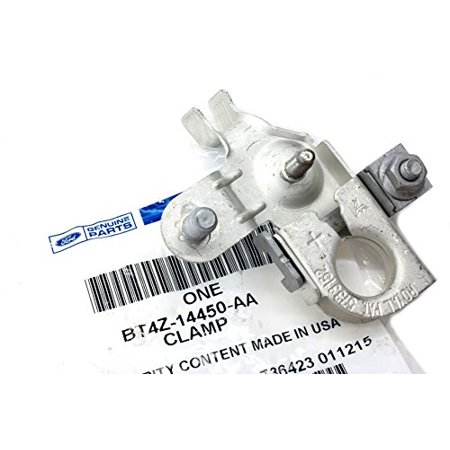

You do not have to replace the entire harness. This is part part number you need "DA8Z14526A", not the small clamp shown in the photo. Put "Ford Part Number DA8Z14526A" in a Google search and you'll see the entire positive terminal clamp with red plastic cover. Unfortunately due to the defective OEM battery that had a loose positive terminal post I had to do this repair.

You are right Jim. That looks like the one I have. I took another picture of mine, both + and - clamps. The vertical wire appears to be soldered as well.Hi Peter,

I was not aware that the design of the clamp had changed, good point. In any case, at first glance, it does not appear that the entire harness would need be replaced.

Great pictures.
I'm beginning to wonder whether it's the model year, trim level, or engine that matters. If I'm not mistaken the Limited, Sport, and Platinum trims have higher capacity batteries than Base or XLT. Or it could be the 3.5L Ecoboost(?)... I'm not sure why\where a particular connector is used.
Anyway, the outlook isn't good for us. Those connectors have an open barrel style crimp connection. It requires a tool with a special die to roll those edges back around and onto itself. They're not common (especially at that wire size) and expensive if you can't borrow one. If you're lucky enough to catch the corrosion BEFORE it reaches the crimped area, you could carefully cut the connector off and crimp a new one back on (remembering to pass a piece of adhesive heat shrink on first, so you can seal the repair after).
But most of the postings here show corrosion that has spread quite far. Once corrosion reaches the wires, trying to re-crimp (or solder) to that area is a real no-no in the industry. You can try cleaning the wires with vinegar and using pliers to crimp it on the best you can... and it may very well be good enough... but it will never approach the current capacity of when it was new. I wouldn't hesitate doing this to get through a summer, but I personally wouldn't risk it through a winter.
