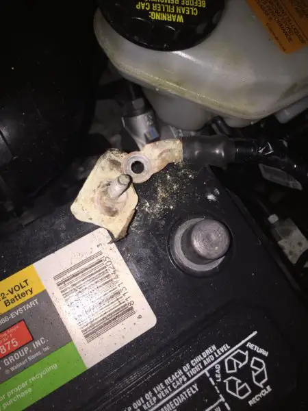

I got hit by this last weekend. Noticed it was turning over slower when starting. Lifted up the positive terminal cover and found this. 15 months old and 16k miles. I change my own oil and am under the hood occasionally looking around. But i wouldn't think you had to lift the cover to inspect the positive terminal in a fairly new car. The next morning it was dead. Tried to remove the clamp to clean it but couldn't budge it and the terminal itself seemed pretty loose. Jumped it and drove it to the dealer who took care of it immediately. Warned my coworker who has a similar Ex and she said 'oh yeah that happened to me a few months after I bought it (new).' :dunno:
Just wondering what "took care of it" actually entailed? Did he replace it or just clean it?

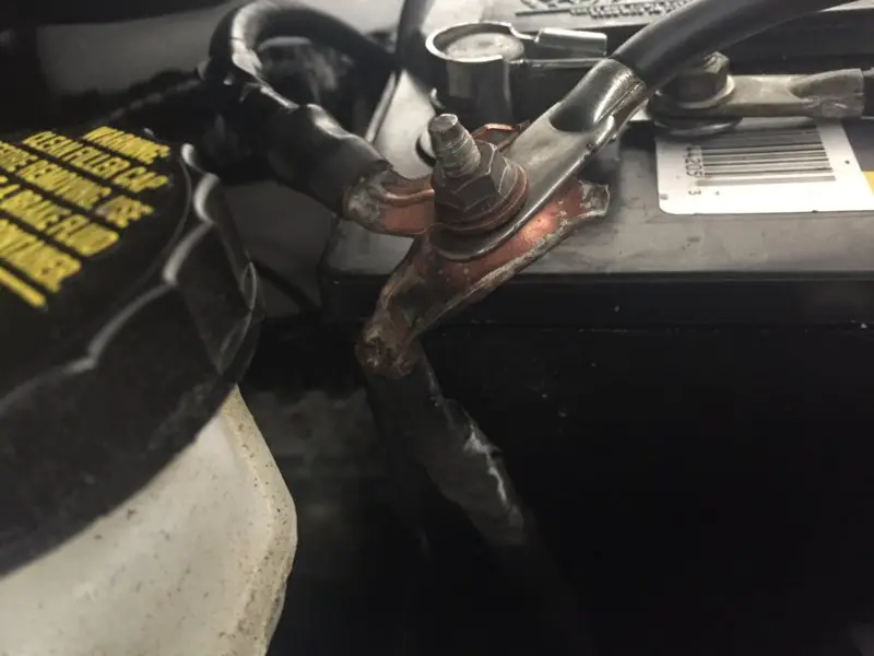

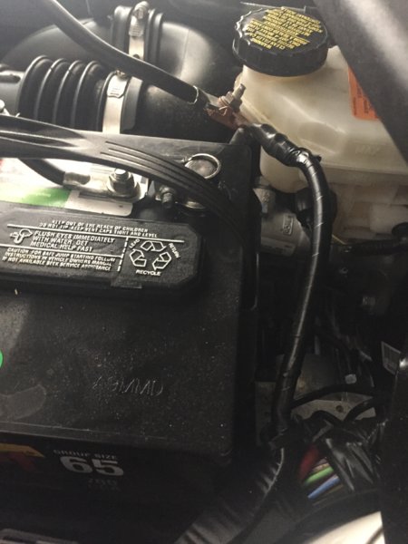

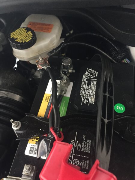

Just purchased this 2017 explorer sport last month. Love the car . The vehicle however cut battery off 100% one day and when i opened the hood i found corrosion the the positive battery cables, also thought that the cables looked out of place for some reason so i was wondering if this looks like normal wiring to you guys . It looks like the cable is split from a main connection to maybe a fuse box and then the battery . Here is the pic
When the cable split to the battery terminal the cable seems extra long as well. I purchased the car used so i dont know if the car came from the factory like this or it is something the previous owner did.

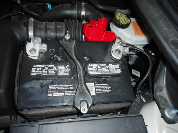

That doesn't appear to be the original battery. There shouldn't be any cables crossing over the battery either. Here are pictures of the one in my 2017 Platinum. Does yours still have the blanket around it?

Check again. I posted before attaching pics.

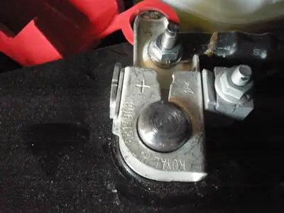

Yours seems to have a completely different + connector. This what it should look like.
Yours seems to make alot more sense to me, just not sure why it would be set up so differently. The corrosion was on that 3 puece connection. I cleaned it up and the car seens to be working fine now .
Hard to tell from the pics, but is the negative terminal by the brake fluid reservoir? If so, maybe wrong/generic battery or battery was installed wrong and looks like some generic aftermarket parts were used to make it work.
Folks that don't know cars should always have an inspection done by a competent known mechanic before purchasing used vehicles. Previous owner of that vehicle shouldn't be allowed to work on cars or drive them.
I am not sure this was mentioned before, but there is a new SSM-48123 that states that you can use Positive battery cable clamp BT4Z-14450-AA and negative battery cable clamp BT4Z-14450-BA even for the Explorer.
