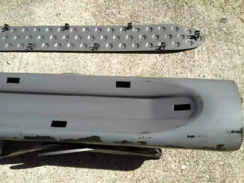

Okay, I never pried hard enough to break or pull off the step inlay, but there is a channel running down the length of the top of the main bar, under the plastic tread inlay. The end "horns" have short metal supports inside:

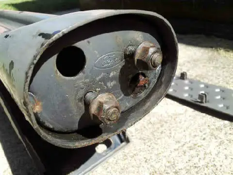

The support is bolted thru the plastic - I unbolted it and put it back on:
The supports are attached to studs that are part of an internal bracket that fits inside the ends of the bars... I _assume_ that if the tack welds were ground out you could remove the internal brackets and see all the way thru the other end. I was thinking if deleting the horns from mine, in which case I'd be opening them up like that and could post pix, or you could figure out how to pry off the step inlay and see thru holes what they used for the 6 female threaded bosses on the bottom where the brackets attach.

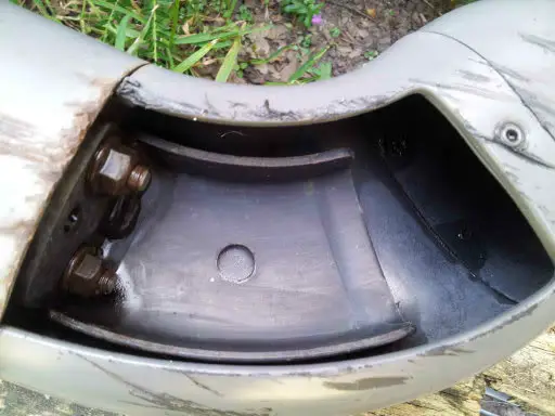

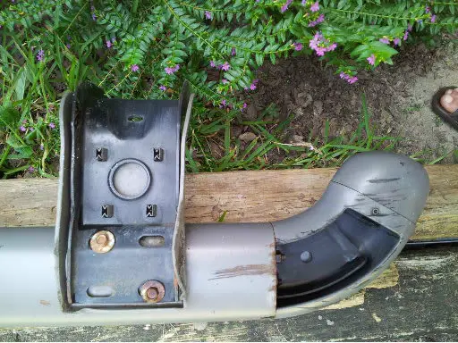

Once you take both the curved ends off, there are some peek holes you can see inside. Mine have a welded seam running straight down middle of the bottom side, right through 3 of the bolt bosses (which I believe are installed from inside, and maybe friction-welded in place.
Couple more pix...
After stripping it down, it's easy to see inside - nothing in there except the 6 nut-serts and the studded plug pieces at each end.
