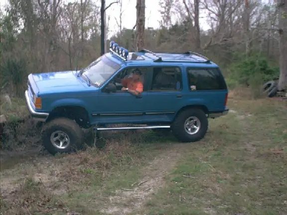

I picked this one up from a friend , had to drill through the roof and run some braces but here it is.
