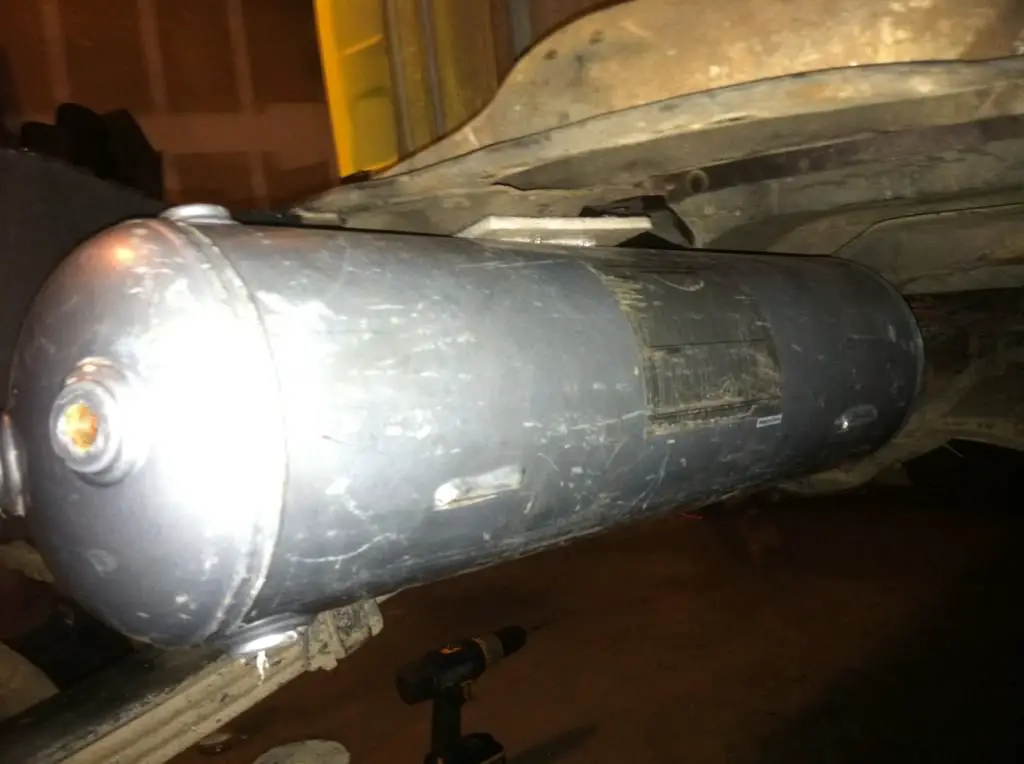

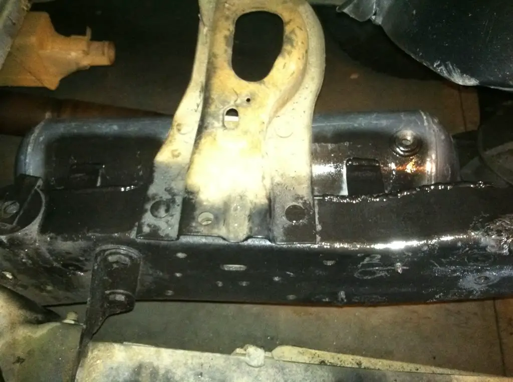

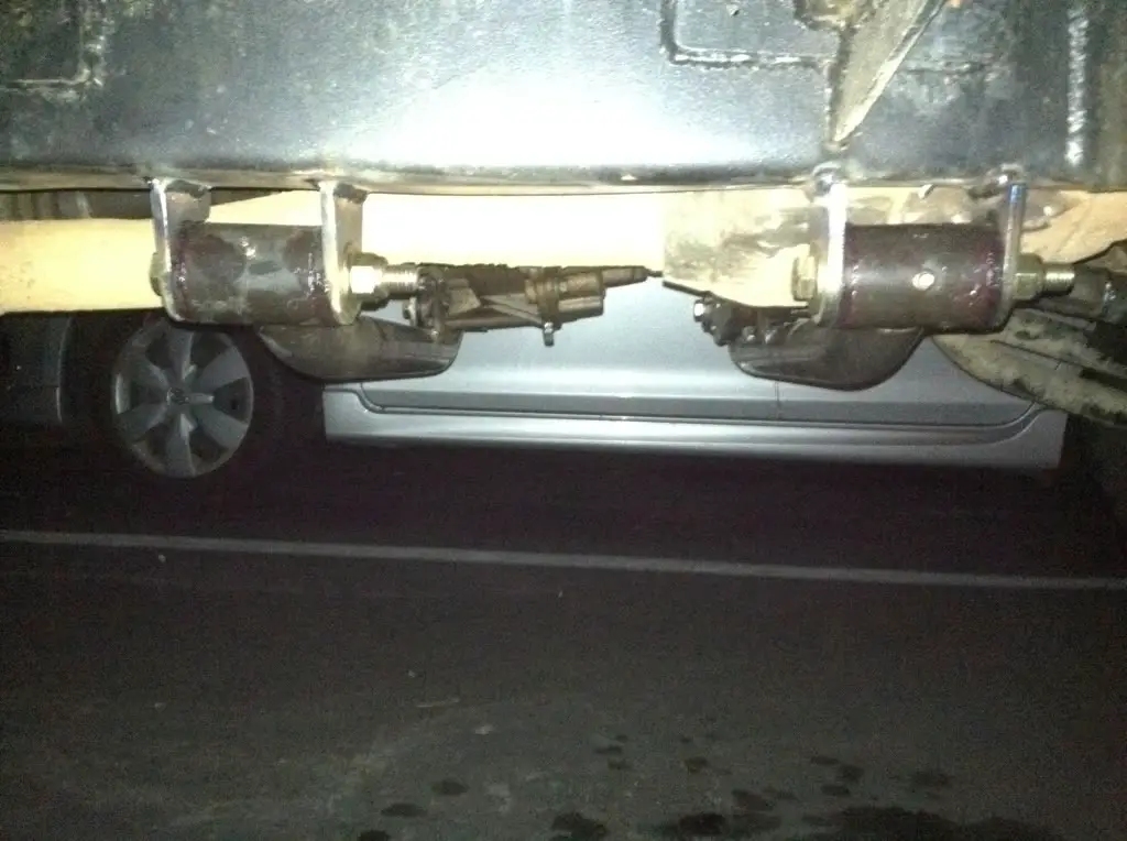

Worked on the truck last night for ENTIRELY too long. Took some 3/16" hot rolled and cut it down to match the frame. This is entirely too thick for what i needed, 1/16" would have sufficed. Whatever. Anyway, with the fuel lines and wiring running along that side, i wanted to be sure i didn't burn into them, so i kept a spray bottle close and soaked everything with water. The welder did not like this. As you can see below, my welds look like **** (what else is new) but they penetrated good enough.
Anyway, i mounted the air tank on the frame. I type too much
Pictures.
My gangster welds
side shot

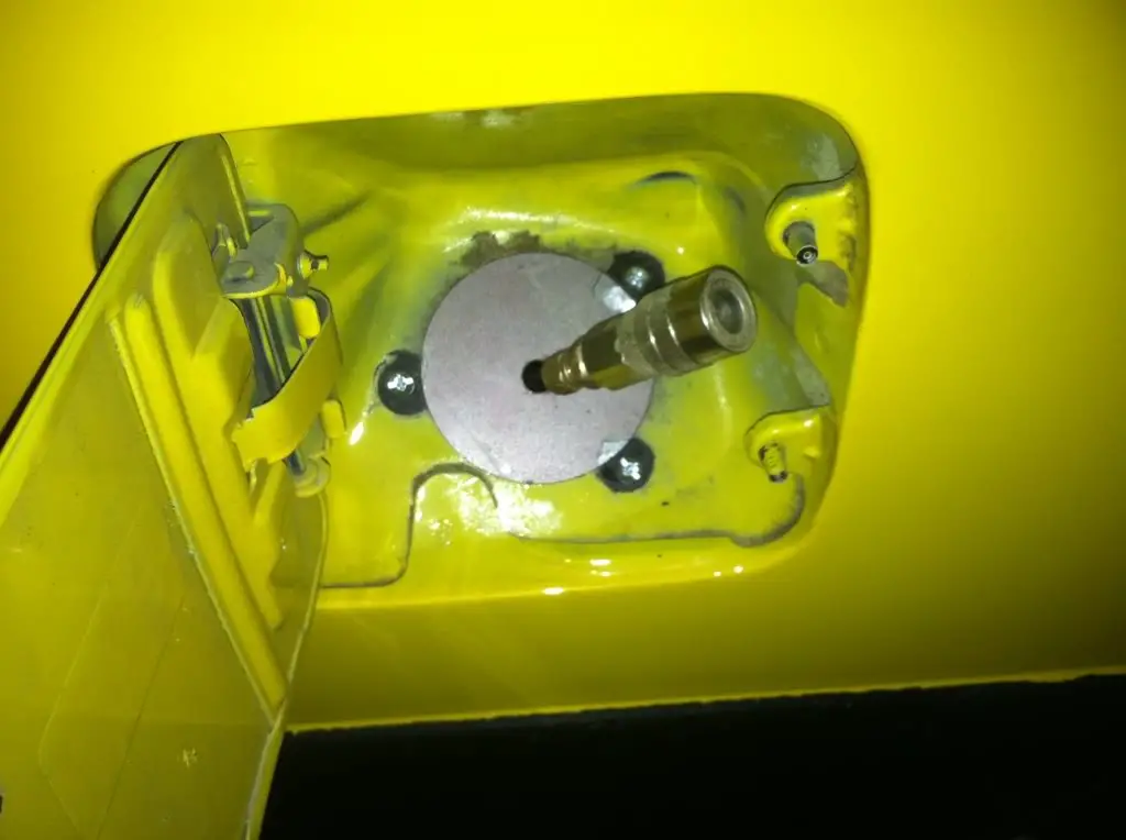

Then i took some sheet metal and mounted the air chuck or whatever its called.

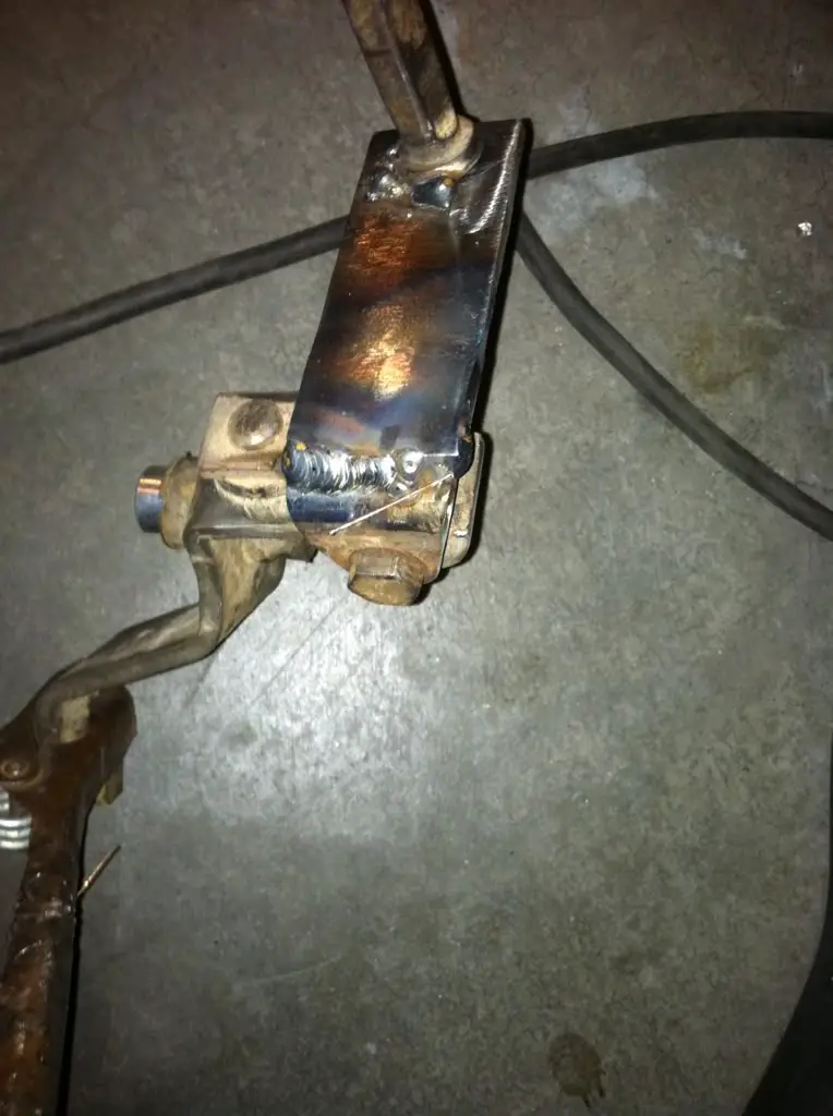

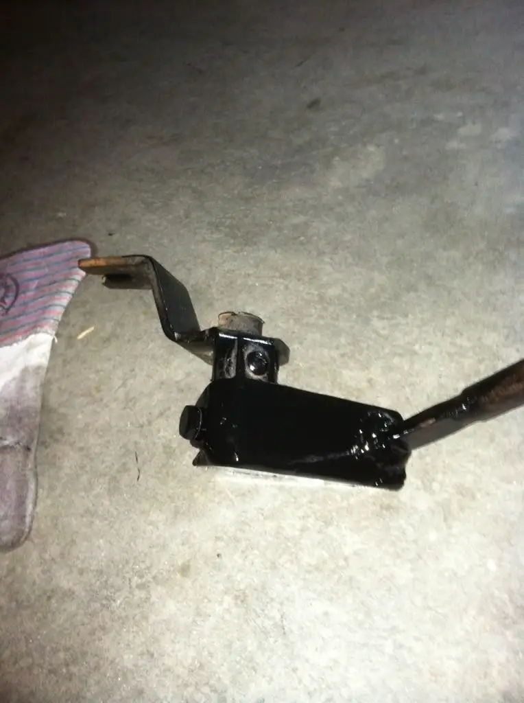

Then it was time to get the crawl box shifter mounted to where i could use it....

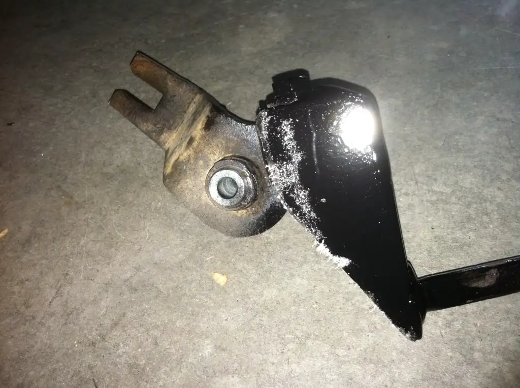

1st, here is the stock 1350 shifter that i received when i bought it. It is sleeved so i could use a smaller bolt in the hole i wanted to use on the Transmission Adapter
Then i cut off the shifter handle and cut out a small piece of 3/16" and test fit everything
Once i had it fitting, I burned everything in. Welds are getting much better.
Then i cut a piece of 1/8" plate and made a gusset for the shifter. cleaned it up a bit, and shot a quick coat of paint to keep from rusting
Then just installed it.
