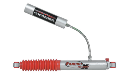

I just picked up a set of shocks too...Rancho long travel Pro series w/ remote resivoirs. 19" compressed!!! That's about how long my stock shocks were extended!!!
How much travel do they have? Can't wait to see pics of those. :bounce: Are they adjustable, other than how much nitrogen you charge them with?

Those are the 9012's, I have the same type shocks up front except for the reservoir.
