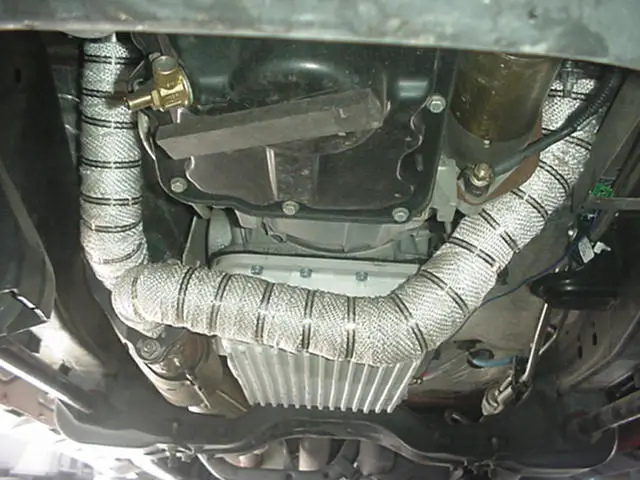

They are deeper by at least 1.5 inchs, Just use a 4x4 filter, snaps in place with o-rings, has an extended pickup that go's deeper into the pan
right but if you have a 4x4 version start with then they cannot go deeper because nobody makes a filter that would fit.
Some transmissions use a bolt to retain the filter some just rely on the press fit of the O rings.
