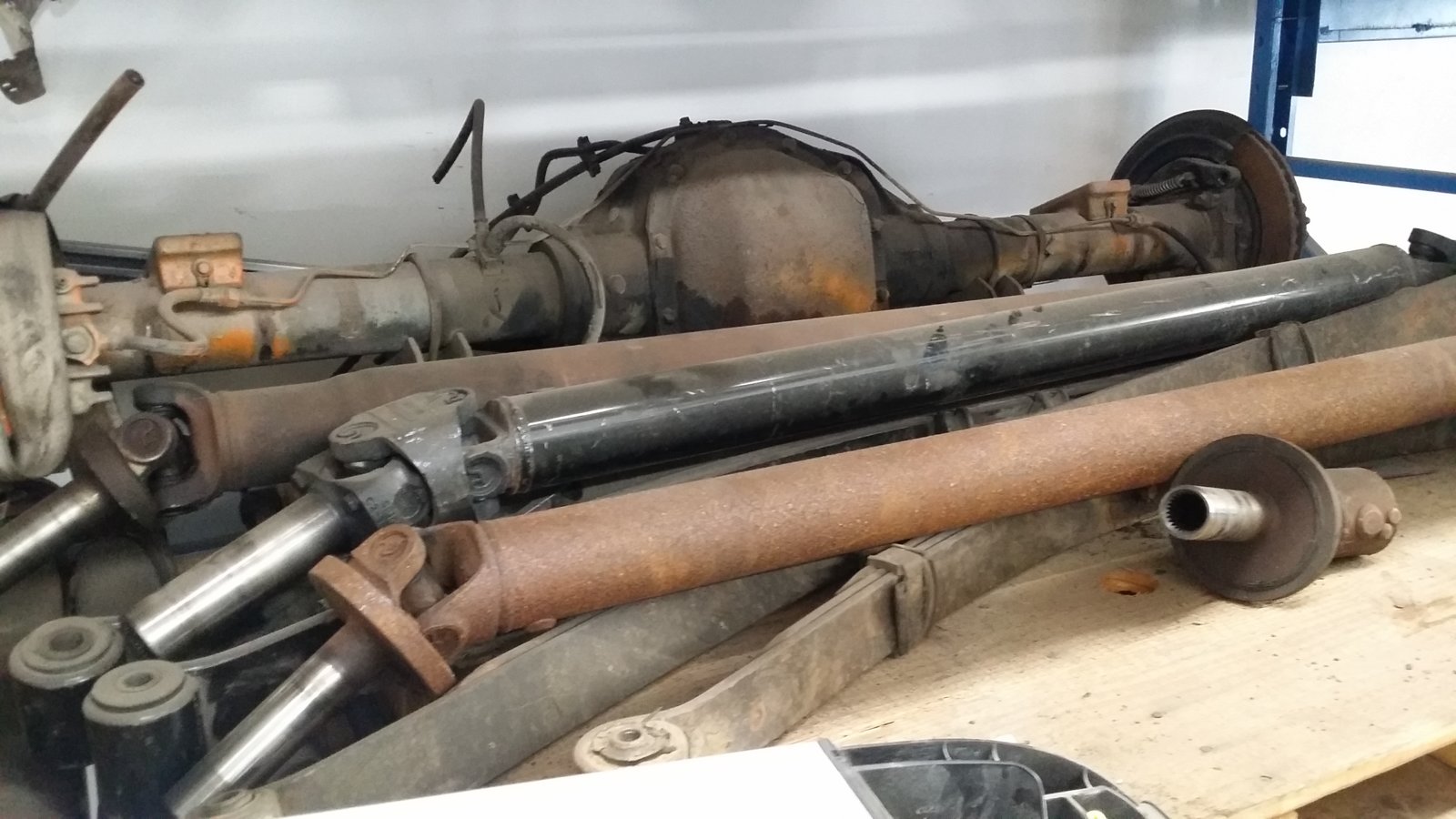

Fixed yoke would be ideal but slip dc is readily available. Heck I'd sell you mine if you want to try it. You'd probably have to shorten it though. It's the black recently retubed one in the pic.

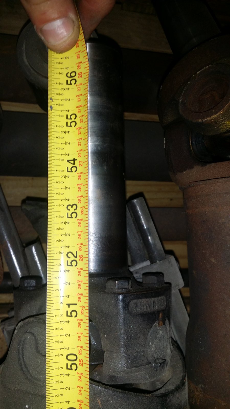

Any chance you have the length on that?
